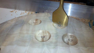

- Posts: 1
- Joined: Fri Jun 01, 2012 5:44 pm
Re: What size cove router bit for recessed knobs?
Funny, I didn't even think of using a router bit, mainly because I would have had to buy one. I decided to customize some spade bits that I hardly ever use for my last build. A few seconds on the grinder and they were done. They didn't leave the smoothest bottoms, but with a few seconds of sandpaper they were perfect. I made two sizes so I could recess the jack on the side of the guitar too.
