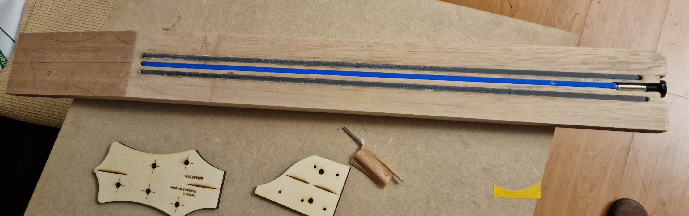

Started the neck, using predimensioned lumber, and no laminations, so that is easy
It is a bit of an experiment, the meranti is VERY light so keen on finding out how it behaves. I have glued in two 5.5mm carbon tubes (kite rods), in addition to the trussrod.

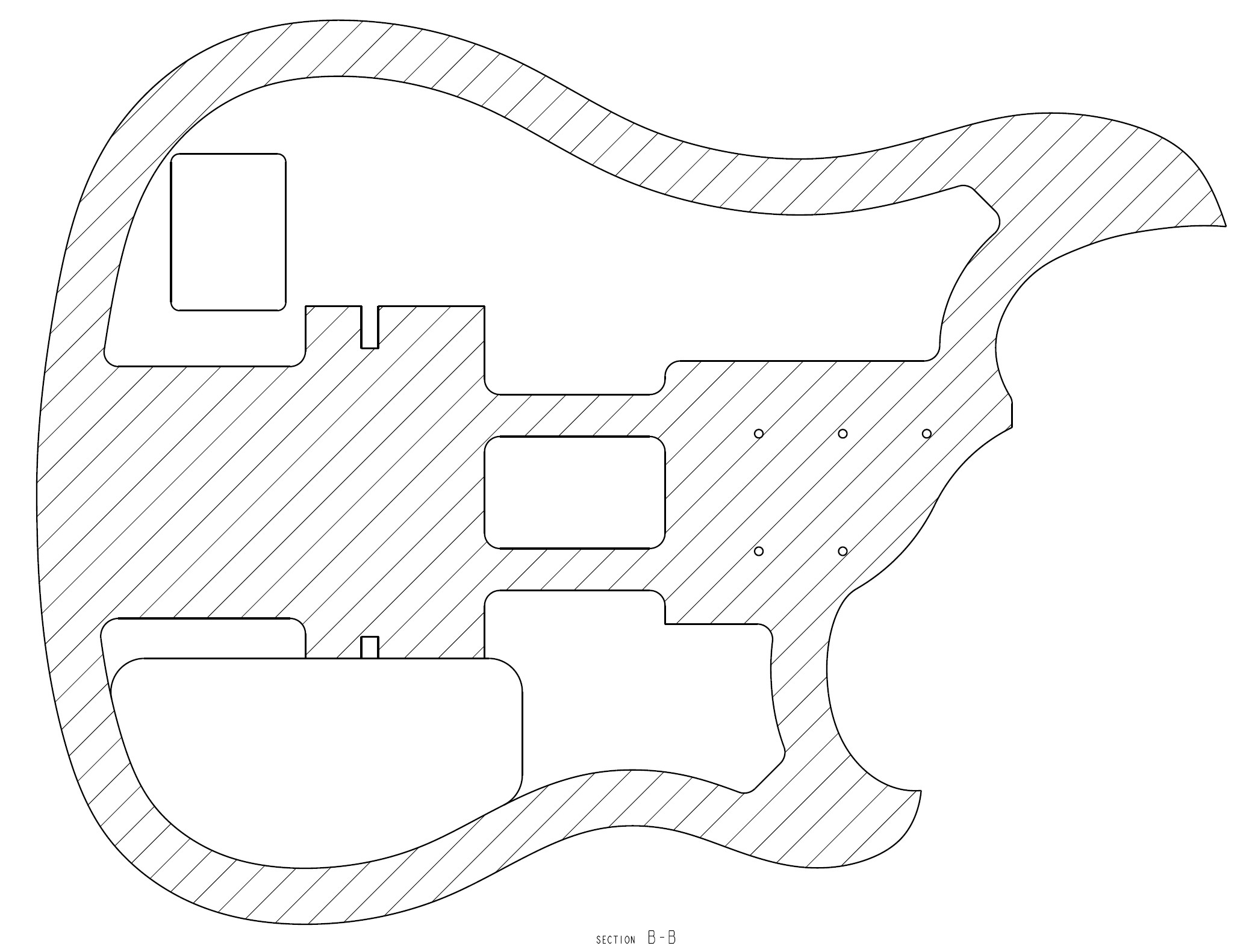

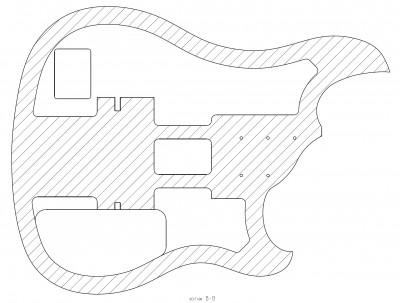

Also glued on the veneer for the headstock. This will be the chambering. The body is shaped like a cylinder, so it is 40mm in the middle section, going to 20mm on the sides. Ordered an Engelmann spruce top, so it will be acoustic-esque

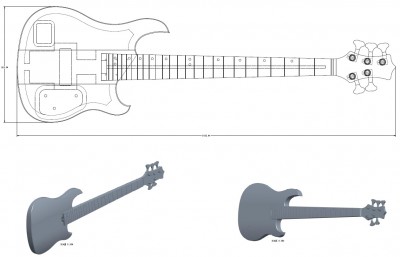

Changed the drawing somewhat, and I've added the drawings for body and neck. Will say that in these calculated fret positions, there is a bit of a rounding error in the calculations of my 3d model (max 0.044mm so, maybe not dramatic

It helps to make a drawing of everything....

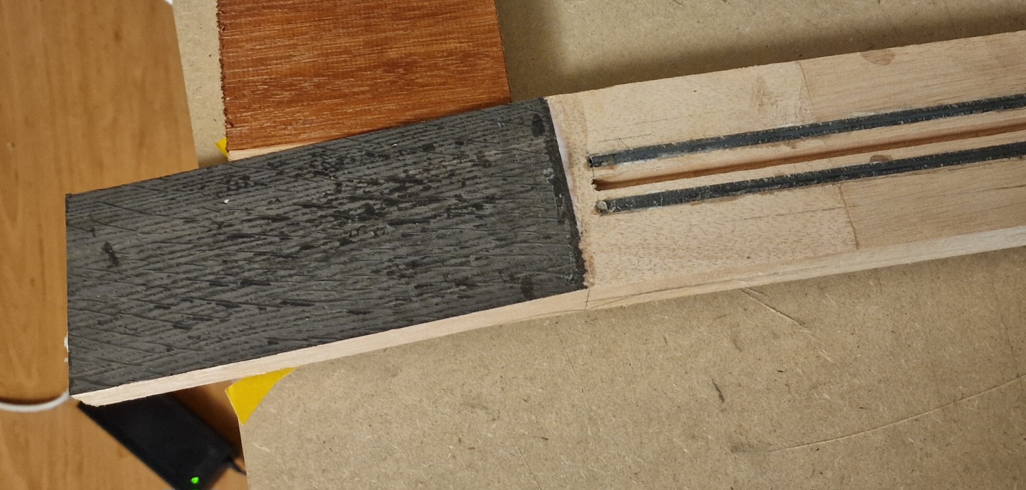

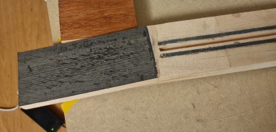

Trussrod and carbon rods
Thought about having them fan out, but they'd be right where the neck attachment screws would, caught that one in time few.It helps to make a drawing of everything....

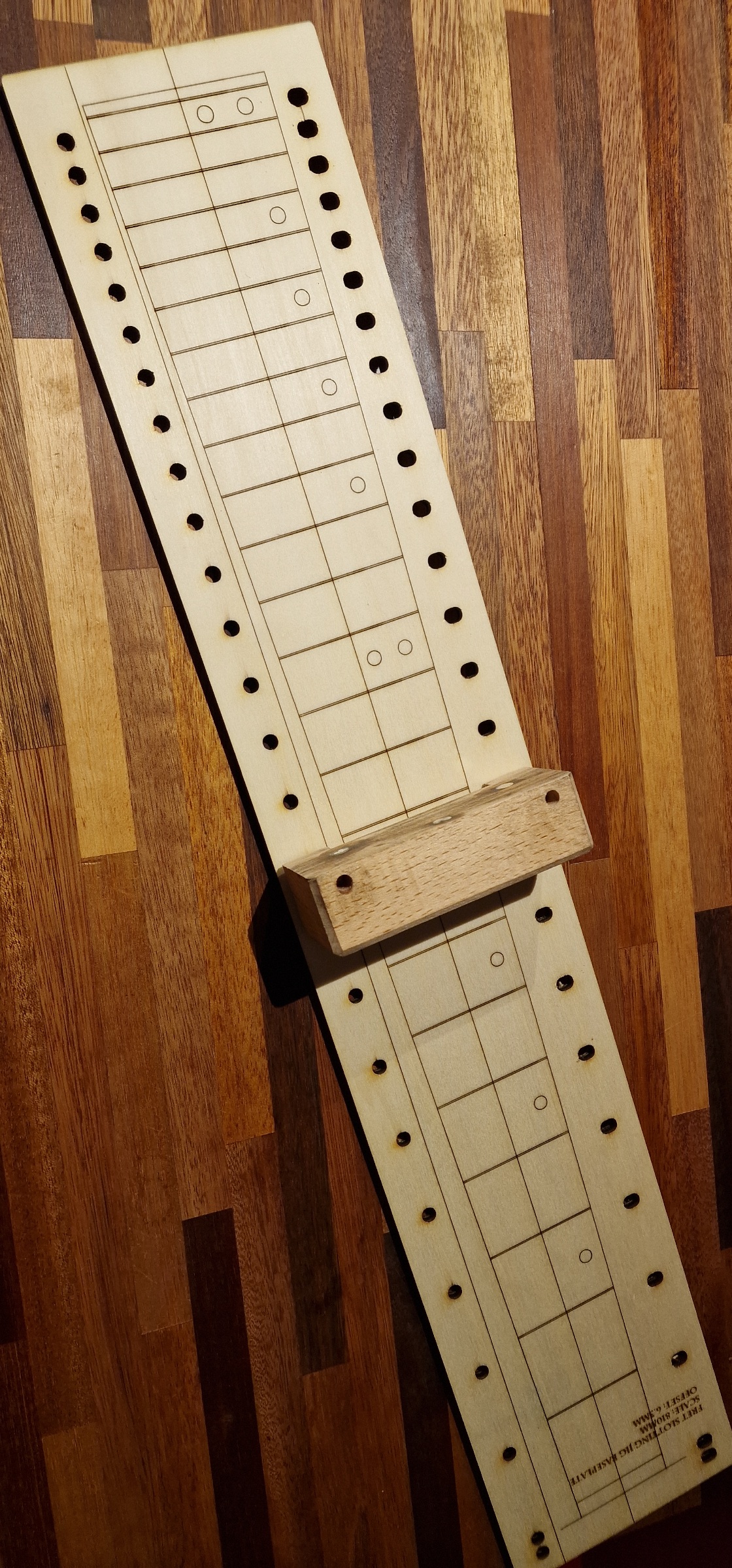

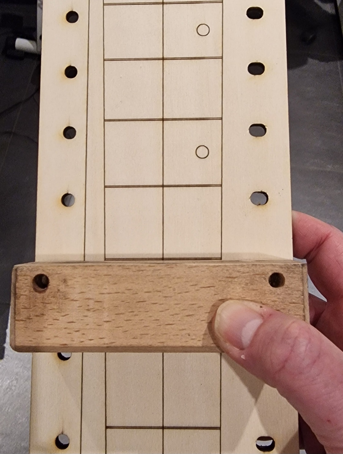

Cut the baseplate with locating holes to cut the fret slots.

Accuracy is pretty good, the saw guide bridge with magnets I made for the little travel bass.The wood for the fingerboard will probably delivered somewhere the end of this week.

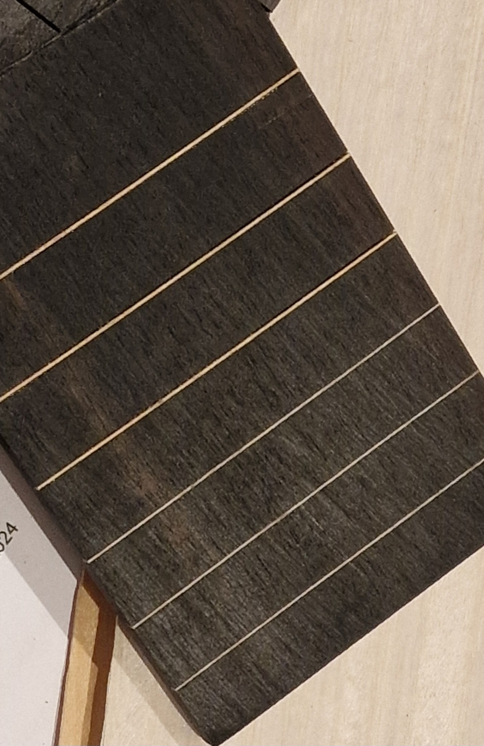

Sawn fretslots, front and sidedots drilled. Made a "mistake" for the sidedots, it is going to be a fretless, so thought about shifting the sidedots to on the fretposition, rather than in the middle. They are aligned with the front dots now, and the fretlines will be deeper so they are visible from the side. No worries.
Also made a little test with two types of veneer for the fretlines, also ordered polystyrene, still need to try that. Will fit lines after radiusing, as the black dust from the ebony gets in the pores of the veneers.

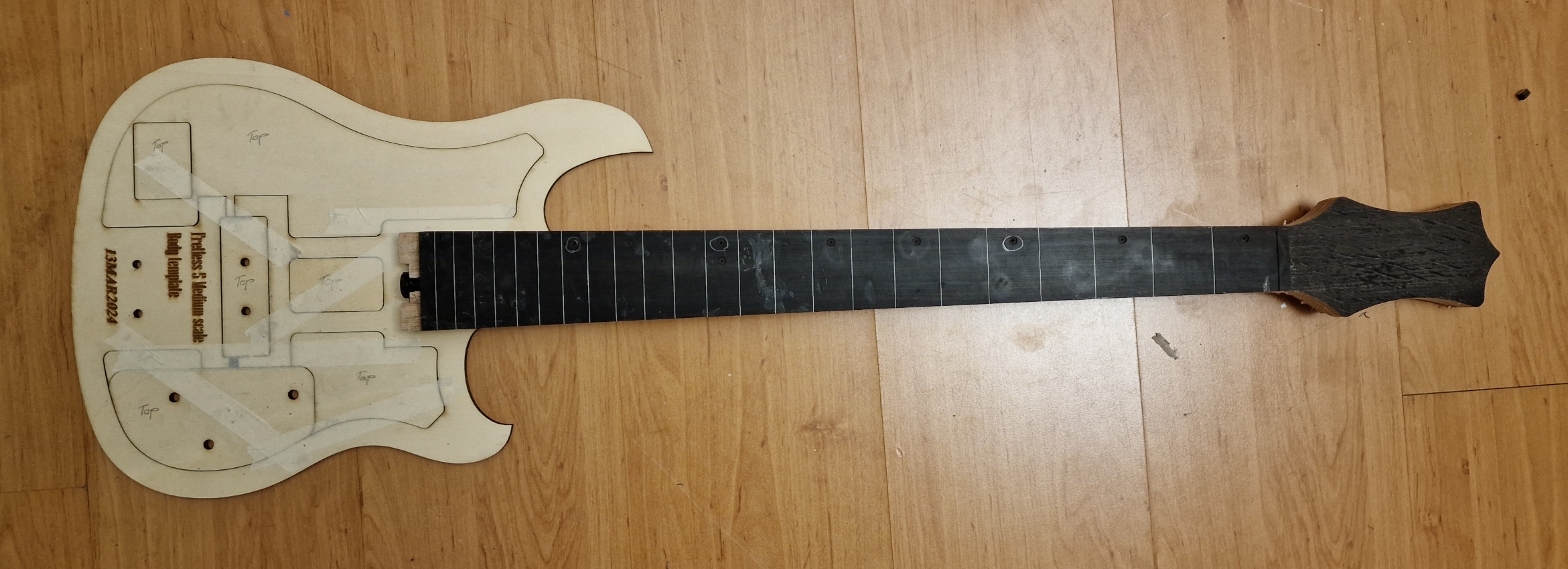

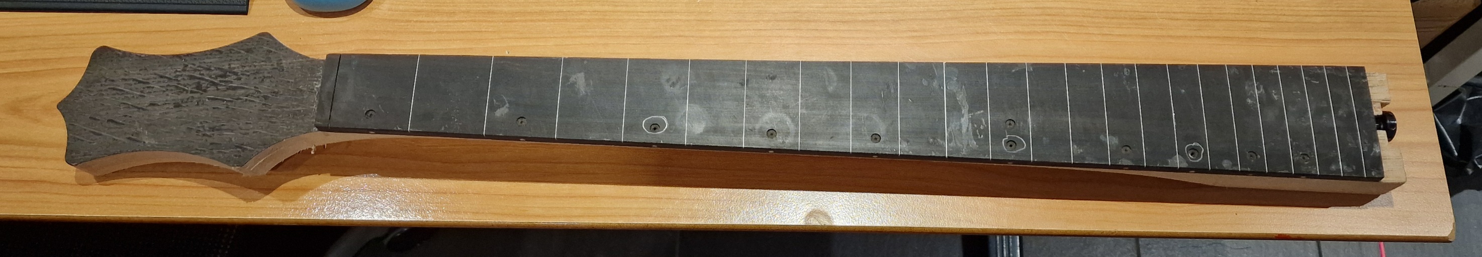

Fretboard prepared, sidedots fitted, headstock routed (will need to do some repairs because of a few blown out corners, The bigger follower bit I have is not as sharp anymore, will need to give that a go on the diamond plates.
Glued on the fretboard on the neck, and started neck shaping, a very enjoyable job, who doesn't love a sharp spokeshave?
Will need to be careful, because apart from the trussrod, there are two carbon tubes buried in the neck. The neck does feel considerably more substantial now, so confidence of it holding up is rising (until it drops sharply again, let's hope not

I noticed your earlier post re: experimenting with a couple of veneers and polystyrene for the fret line inlays. I'm (very) slowly approaching the time when I'll have to commit to a fretless line material for an ebony electric cello fretboard. What material did you end up using... is it polystyrene?
- Posts: 83
Re: Moving on, a chambered 5-string medium scale fretless
Yes, I went with the polystyrene, as it was the most consistent in colour, easiest to see, and also pretty easy to work with. Can post a closeup of it if you like.
Are you going to go with full fretlines or partial ones (think I've seen those also, not on a Steinberger though, not sure)?
