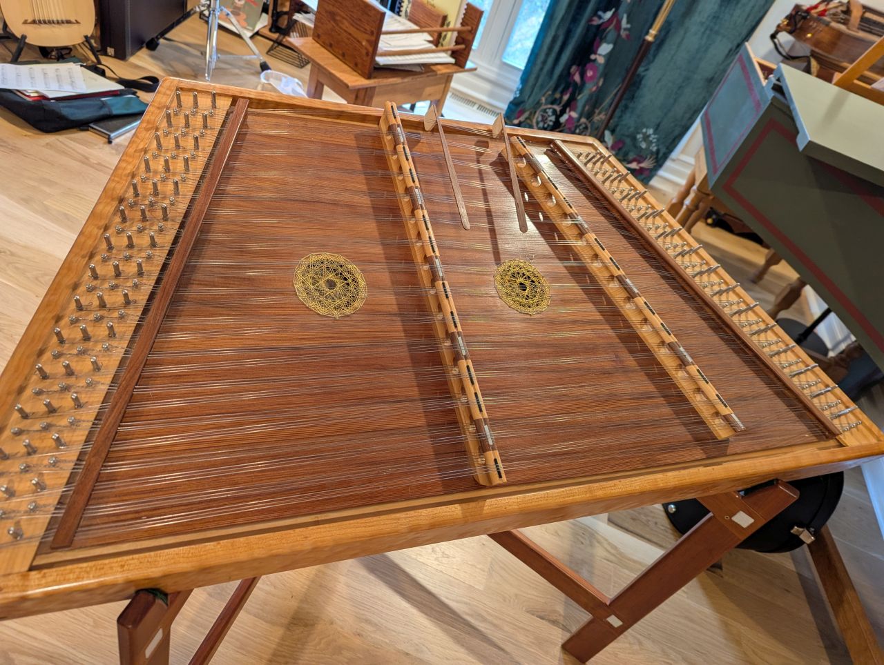

Just wanted to share an update. The instrument is done, just in time for the concert next week. Thank you Charlie Schultz for the recommendation of Charlie Alm's book. If found a copy and it proved very helpful, as did all the hammered dulcimer discussions in archived in this forum with Deb Suran and Sam Rizzetta's articles for the Smithsonian. My eventual design ended up being a combination of all of these ideas. As predicted, tuning all 97 strings to such small gradations of pitch is a huge pain, but I'm getting better as I go. Here are a couple of pictures:

Congratulations, Javier. Nice job! If there is any chance you can get a short audio clip of it being played, you can upload it here. I'm sure it will be "different."
