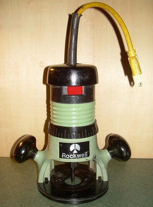

My favorite small router is the Rockwell 64 (a.k.a. PC309 - newer model) which can sometimes be found as a 50+year old N.O.S. item at estate sales or on eBay. They were marketed as a "joe homeowner" item and sometimes were put on a shelf and never used. They are in between the size of a trim router and a 1hp size and can take both a small two handled base or a trimmer base (no plunge base available). If you can find one in the $25 - $35 range and they are in good condition they are not a bad buy. I grease the bearings with lithium grease before putting them to use because of their age.
The smaller base PC version (a little too beat up?) : https://www.ebay.com/itm/225791927143?h ... R5C606j1Yg
And the older model with the two handle base (pictured)
