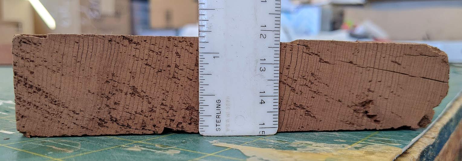

Since I'm coming to the end of my building "career" for age and health reasons, I figured I might try an archtop before I check out. It has the potential to be a disaster, so I'm not going to spend any money on it. I have this redwood board, with a usable dimension of 13" x 47", thickness 1.3", near vertical grain variable from about 19 to 25 lines per inch (already used part of it for a flat top).
I can see 3 options for using it:
1) Resaw an appropriate size piece to 2 thin book matched pieces about 1/2" thick - this won't give an appropriate rise to the arch, but maybe I could make it flatter than usual.
2) Resaw a 13" (or 12" to fit it in the saw) wide piece of requisite length at an angle from one corner to the other, giving 2 wedges 1.3" thick on one side to zero on the opposite side, not book matched and opposite run out, but having the requisite center and edge thickness (for a 16 or 17 inch lower bout width.)
3) Cutting two 1.3" thick 20+" x 9" pieces from the whole board, giving requisite thickness but not book matched.
The board is similar enough throughout that visually not being book matched would be acceptable (to me.)
Since I expect this instrument will have many mistakes, though hopefully playable, the top wood doesn't have to be anywhere near the best. The back and sides will be maple, that I have plenty of, and the bridge and fret board probably ebony that I have if the pieces are big enough. The neck could be maple, mahogany or alder.
Any thoughts on that top wood and how best to cut it? (Or maybe just forget it?)

Re: Thinking of making an archtop - how can I best use this wood?
Personally, I'd favor the desired arching over grain matching so I would not do choice #1. Between #2 and #3, #2 seems much more difficult for little advantage. The only advantage I can see is that you'd conserve wood. I used choice #3 on the cherry back of an archtop and it looks great. I never even think about the fact that it's not book matched. I might view it differently if I was building for anyone but myself but even then I'd be surprised if most players I know would mind it. Of course I can't even imagine myself selling to collectors or anyone in the high price brackets but I'd guess if you were doing that you wouldn't be asking this question.
So my choice would be #3.

- Posts: 3253
Option #3 would be highly preferable to the other two. What you would be doing is called a slip match. I think no one would ever notice the difference since it is the same board. Just be careful to avoid the crack. They usually travel up the board further than you think.
An archtop is a daunting project but with your experience you should be able to pull it off quite well. Don't sell yourself short.

- Posts: 1309

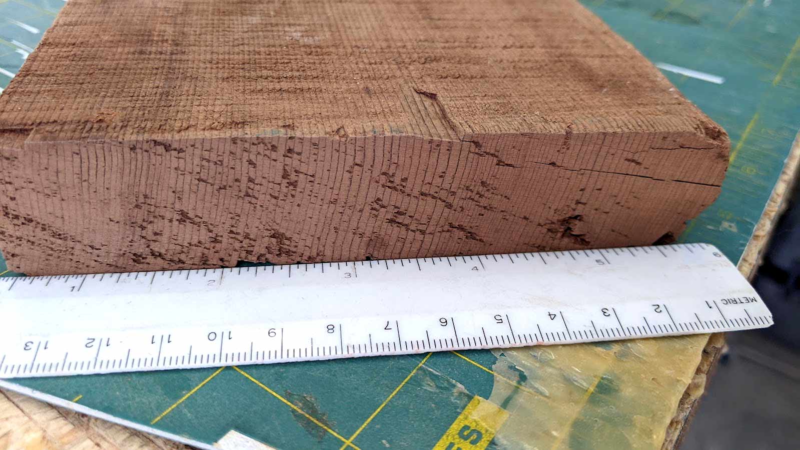

Arch height and top thickness are best scaled together on an archtop guitar. It may seem counterintuitive, but the thicker you want the top to end up the higher the arch should be. If you're not following an existing design and using 'known' wood you'll need to figure out how thick the top will need to be to withstand the bridge down load, and scale the arch from that.
As with most guitars, the most important property there is the Young's modulus of the wood along the grain (E-long), which largely determines the bending stiffness at a given thickness. This can be measured directly in a couple of different ways, and that's always the best idea if you can do it. A short cut relies on the fact that E-long tends to follow the density of the wood pretty well for most softwoods. If you can determine the density (specific gravity, compared with water as '1'), looking up the expected stiffness is easy. In this case, I'd expect the E-long value to be low relative to the density because of the prevalence of hard latewood lines, but there's always the possibility of using a 'fudge factor'...
I note that the grain lines are at an angle to the surface of the board. When making a top from a split wedge the grain lines will tend to be perpendicular to both faces of the wedge, which gets you as close as possible to 'vertical' with respect to the arch, and yields the highest cross stiffness at al points. The actual cross stiffness may not be as important as the fact the 'wedge' cutting makes it more consistent across the top. Given the choice I'd try to cut the wood so that the area in the center is the best quartered; if it goes a bit skew in the wings that makes them somewhat more flexible.
With luck, depending on how deep those end checks are, you should be able to go with option 3, which I'd think would be best. Don't discount the idea of using 'wings' on the outer edges of the lower bout, particularly if these can be kept small, so that the joint falls over the liners.
Keep in mind that redwood has a tendency to split along the grain. Make a good cradle of layers of cardboard glued to plywood to support the outside of the arches once you've shaped them, while you work on the inside graduations.

- Posts: 255
- Location: Murphy NC
One alternative not mentioned here (so far) is to relocate offcuts from the waist area to fill out the width of the lower bout. I have done this very successfully on my builds. The archtops and dreadnought size I have built are 16" wide at the lower bout. I have used some curly maple and walnut for back plates that were resawn from approx 7" wide boards. I carefully joint both edges of the board - one edge is then glued for the center of the plate. There is enough material at the waist to relocate to the outer edge and fill out the width, and since it is from the same board I've had excellent success matching the grain/figure.
- Posts: 255
Oh, and I start with 0.75" thick plates for the front and back arches, so you would be resawing and surfacing down to that before jointing, etc.
- Posts: 1325
Thanks for your comments/suggestions - really appreciated. It's a lot to think about, especially never having carved a plate before, and still unclear to me how to design the curves for the arch and recurve areas. I have Benedetto's book with the templates in the back, and have watched some youtube videos, and read part of your pdf so far, Mike - very helpful.
