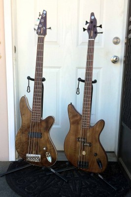

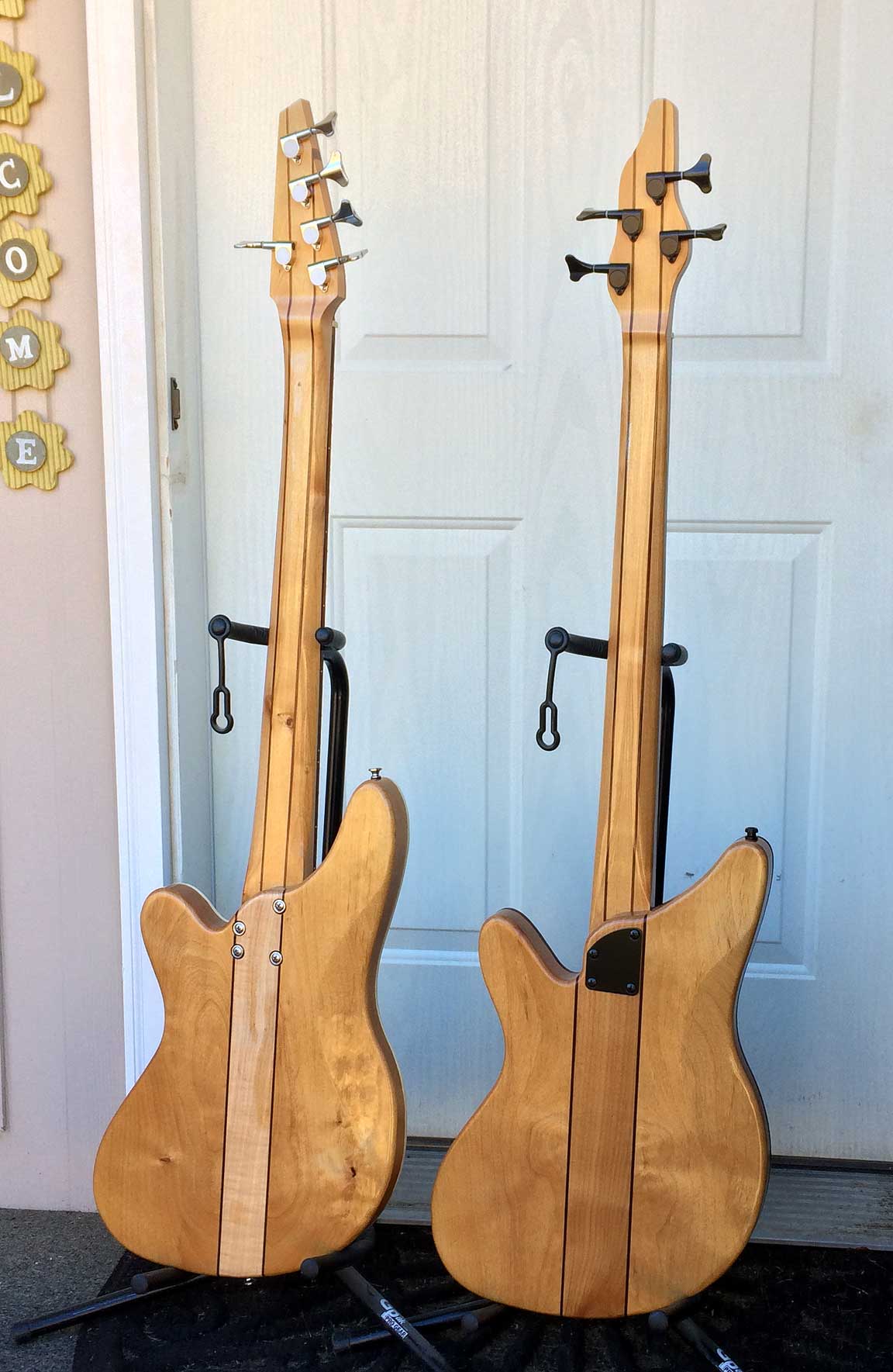

Just finished a couple of basses. The tops are single piece walnut I cut out years ago from a milling offcut. Everything on these is from stuff on hand, except the black tuners and neck plate I bought to fit with the color scheme. Bodies are chambered, alder with walnut strips, as are the necks - fret boards are cocobolo. Stacked pots for tone and volume, strat type jacks, pickups and hardware from China. One top had a knot hole in the middle, so I enlarged it and inlaid a Mexican 5 peso coin. Lots of small defects in much of the wood but that's OK by me - consistent with my abilities.

You call it a defect, I call it character.
The coin is cool. Do I remember you posting another coin inlay?

I've inlaid coins, mostly Mexican but 2 Indian head pennies, in all the instruments I've made the last several years, mostly in the headstock. Easy to do once I matched drill bits with coin diameters.
