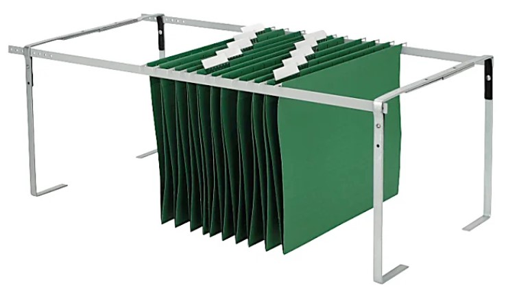

When I worked as a civil engineer, we had two methods of plan storage. Flat files were the premium method but they take a lot of room and are fairly expensive. A smaller footprint option is hanging blueprint racks. Here is what I am talking about:
Hanging Blueprint Rack
