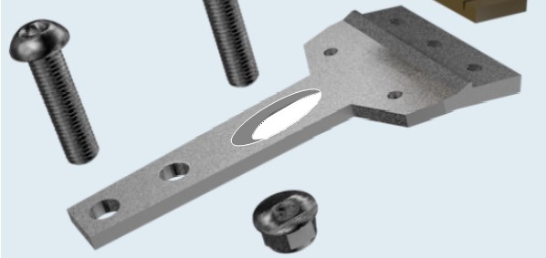

What if I made something like this? the through holes would be well away from the angled part and the strings would pass over a sacrificial piece of brass or aluminum. That piece could be filed to match the curve of the first fret with ramp-like slots leading up to the front edge:

Very nice - safe to say that your truss rod nut is at the bridge end of the neck?

No, I was trying to make it work with the adjustment on the nut end. However, now that you mention it the whole thing would have to come off for a truss rod adjustment, which is sub-optimal at best. I bet I could make the adjustment accessible, though.
If I were building the neck from scratch I'd put the truss rod in the other way around.

Looks like you could add truss nut access pretty easily (with apologies for hacking up your image). Perhaps use oval head countersunk bolts on the strap instead of button heads to allow a clearer tool path into the truss nut?

I was thinking along the same lines. I did away with the top bolt because I think it was overkill and would have meant drilling through the LP signature on the guitar I'm using. I doubled the size of the woodscrews and moved them further away from the center. I think this one is better looking, too
