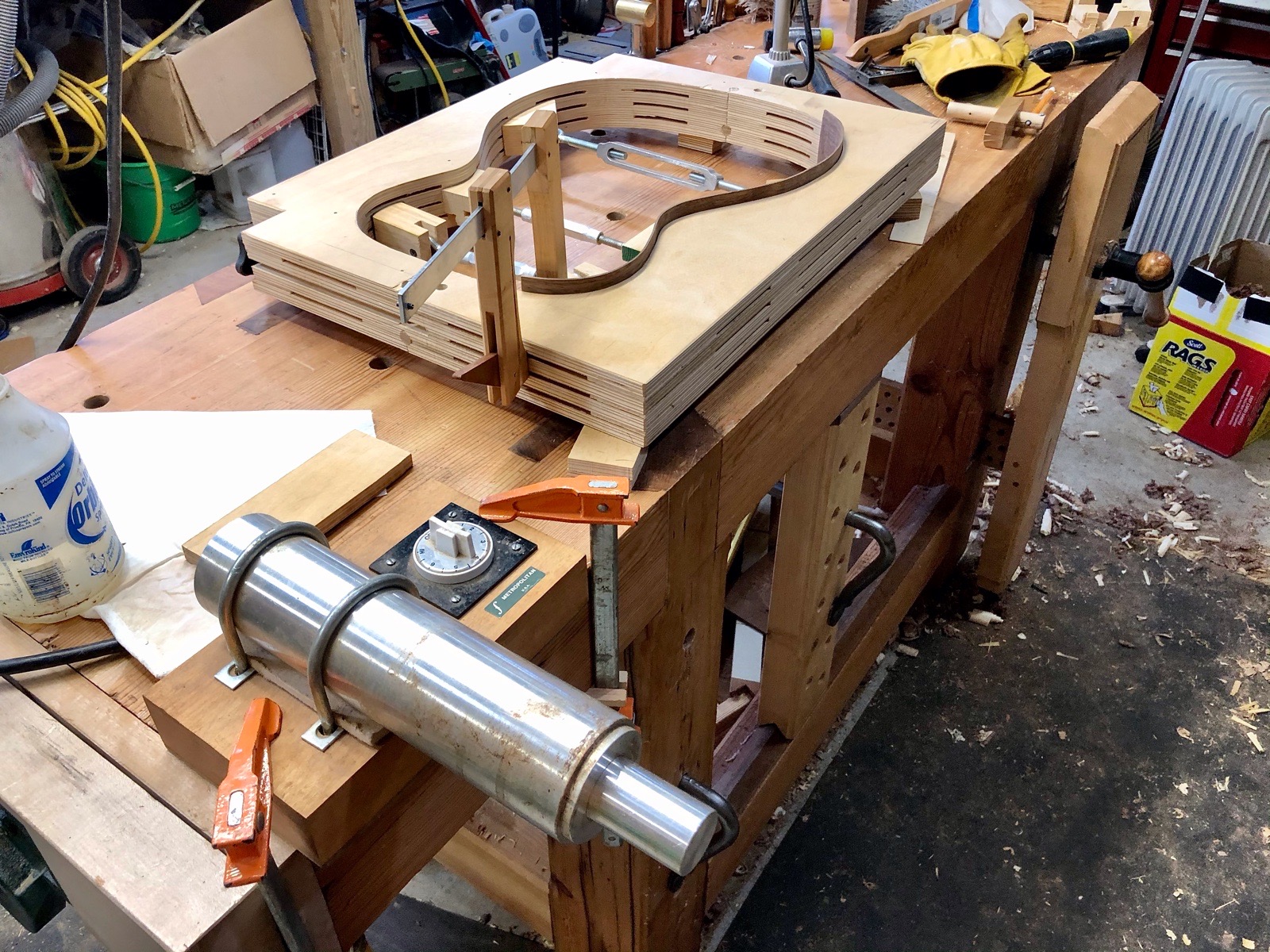

Hello, I’m working on my first guitar, an acoustic flattop, and have some beginner questions for the wizards. I built a mold and I’m practicing bending sides. Here’s my best attempt so far. My guitar’s back and sides will be walnut and this test piece is a pretty good match, it’s just short but fine for practicing.
This is my bending setup. I have an old bending iron I got from LMI a long time ago. I don’t think I‘ll ever have the space or need for a fancier bending system.

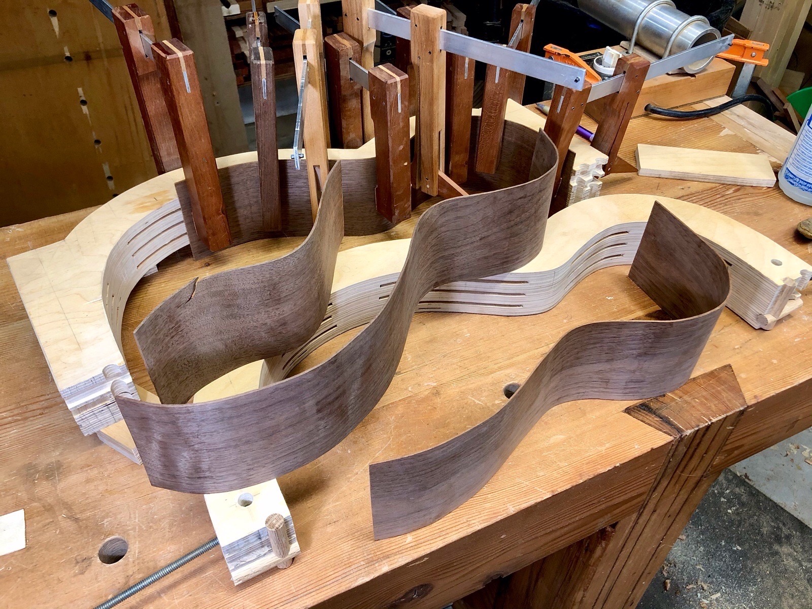

The bending seemed to go well, my main issue is bending too far and needing to bend it back. I thicknessed the test piece to around 0.075”, it’s pretty consistent.

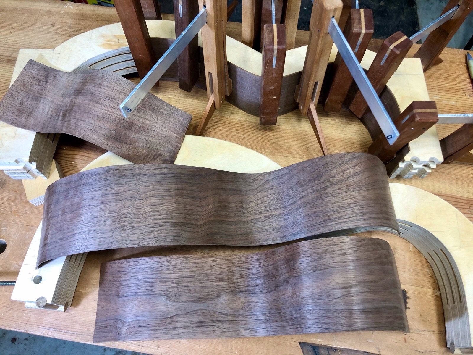

First question. How lumpy/bumpy is acceptable for a bent side? The walnut is not homogeneous and different sections bent a little differently. This results is a surface that’s not fully flat along the curves. Should I be striving for smooth and variation free?
Next, the flat ends of the test piece are cupped a little. Is this a problem? With a full length side the ends will be glued to blocks and there’s no cupping where the wood is curved.

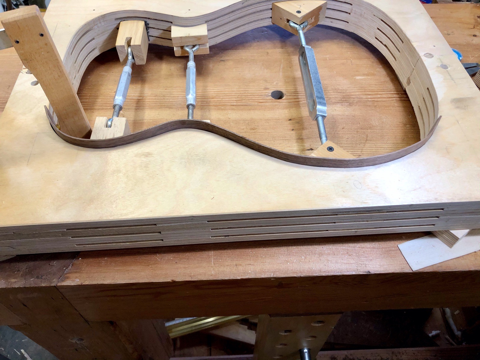

Finally, is it correct to assume that I should leave the side in the mold until I can glue in the blocks and maybe the kerfing?

You have done well. You are good to go. Slight waviness or other irregularities will sand out. And anyway, nobody else will see the imperfections that you imagine are there. Bending by hand on an iron is a great way to work. You don't need anything else, unless you are a factory trying to crank out dozens of sets per day. If you over bend it will often spring back naturally, or you can use the hot iron to correct it.

Bending like you are doing is exactly how I do it and so far I haven't had any issue sanding out any irregularities. Once I started building guitars, I have only built mandolins with very curly maple sides, I found that rosewood is the easiest wood to bend so far for me. I haven't tried walnut. I'm so tempted to buy into the heat blanket and jig thing only because it appears to be so much easier and probably more accurate.

For me, I can leave the sides out of the mold as soon as they are cool, and if you use water, dry. I found that understanding the plastic transformation of the wood solid with heat was critical to getting smoother bends, I try to get around a 4" section up to bending temp, work the bend in slowly across the whole width of the part I'm heating, and try to flow it down the piece. I do go back and adjust the radius of the bend if needed, re-heating seems to be OK. I bend quite dry, I have a little water to generator a little steam if I feel I need it, but I consider that I'm heat bending, not steam bending.

Two of my archtop guitar builds had walnut back and sides, and I found that walnut is more forgiving than curly maple or figured cherry. 0.075" thick for the sides is plenty thin enough. I found that steady light pressure while rocking the wood back and forth spreads the heat out, and occasionally turn over to heat the wood on the opposite side. You will feel when the wood relaxes and accepts the bending. About 350 deg F on the pipe is good, and I did not soak the wood before bending, just spray with distilled water to moisten the wood and provide the steam that helps the bending. Clamping in the form with flat cauls can help prevent cupping as the wood dries and sets. I keep the sides clamped to the form for about 2 days to be sure they are good and dry.
As the others stated, a little spring back is expected, and the facets you are seeing would likely sand out on the finished instrument. Getting the wood too wet can actually make the faceting worse.

One trick I use is to over bend things initially: it's more important that the bend be smooth than that it be right. Allow the side to cool off, preferably over night, and then come back and un-bend as needed. The parts that bent too far to begin with will be easy to straighten out, but it's often hard to get something to take more bend the second time around. Concentrate on getting the spots that don't want to bend to at least 'enough' curve.
If you end up with a tight bend in one spot and relatively flat areas next to it due to grain changes, don't start by straightening out the over bend. The wood tends to stay pliable for some time, even after it cools off. If you straighten that area and then come back a while later to bend the flats, you'll find the straightened out section will be right back where you started before you get much bend into the flats. The trick is to start by over bending the flats. Allow everything to cool off and stabilize, and then go back and straighten it out.
The moisture content of the wood seems to help by lowering the temperature at which it becomes plastic. The longer you heat it the dryer the wood gets, and eventually you end up scorching the wood without it bending. Ideally the iron should be almost hot enough to scorch the wood, so that you can heat it through fast and bend it before the moisture is driven off. Add water to the inside of the bend; the bonds between cells get weaker when the wood is wet, and you get splits on the outside.

Thanks, everyone. I am trying to apply all the hints and make some progress. I have completed four test runs and the last one seems really nice. It was also a scrap that is much closer to the actual side pieces. I’m going to start working on thicknessing and cutting the sides to shape next. Bending wood like this seems a bit magical, very fun.
