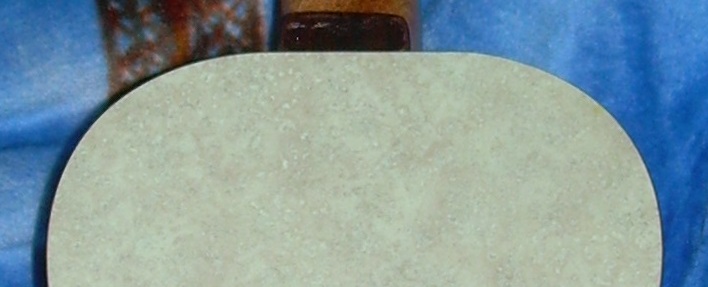

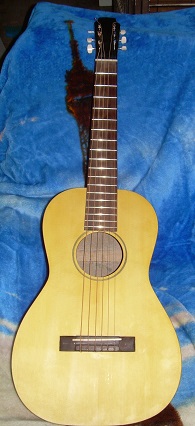

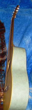

It's been awhile since I've built a Formica bodied guitar and I decided I would like to have one as a compact knockabout guitar. I decided to go with a size 1 body shape and my "AR-7" takedown design to take car camping. I used a solid spruce top that was originally sold for tenor ukuleles, and scrounged the rest of the materials, except for(cheap) tuners, fret wire, and strings, so if anyone wants to build a guitar on the cheap this might be a way to do it.
My wife commented that she could hear it upstairs and it sounded pretty good to her. I don't know if that was a compliment, or that the farther away you get the better it sounds! :lol:
I used kind of a slime green pattern laminate.

The takedown style and Formica make this ideal for camping! That color though. . . :)

You don't think Gene Stoner would approve? I didn't have any camo pattern Formica. :lol:

What color is it exactly? It looks different on my phone than on my computer screen. I think the blue blanket is playing a role here. When I looked on my phone this morning it looked greenish (almost like a dirty mint green). Now that I see a larger image on my computer screen, it looks much less green.
I have seen a few of your formica guitar posts and have to admit that I am casually keeping an eye out for a free scrap so I can make a camping guitar someday too.

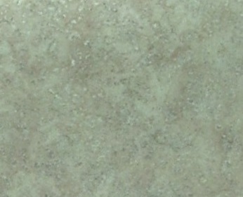

hpl trav grn.jpg (78.09 KiB) Viewed 18712 times
It's more of a light pond scum green. light green with a brown haze in places and light and dark mottles. I can't imagine who would want it for a countertop but there you have it, and some equally ugly color variations of the same pattern.

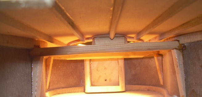

Something I tried on this one was an open harmonic bar and fan bracing extended into the upper bout. I had been using an X fan combination but this is simpler. Torres did something similar as have others, so the concept is not new. I think I made the harmonic bar heavier and kept more of it off the plate. It is resting on a tongue that sticks out from the soundhole reinforcement and supports the area the X usually crosses.
The guitar is steel strung but has a wide flat fingerboard like a classical guitar, which is what I originally learned on and prefer.
