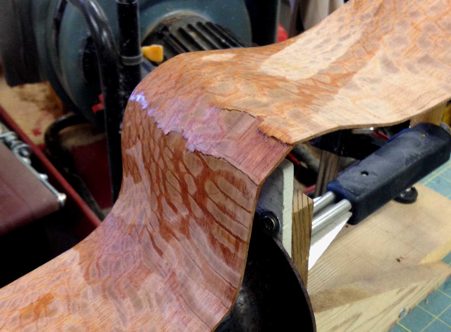

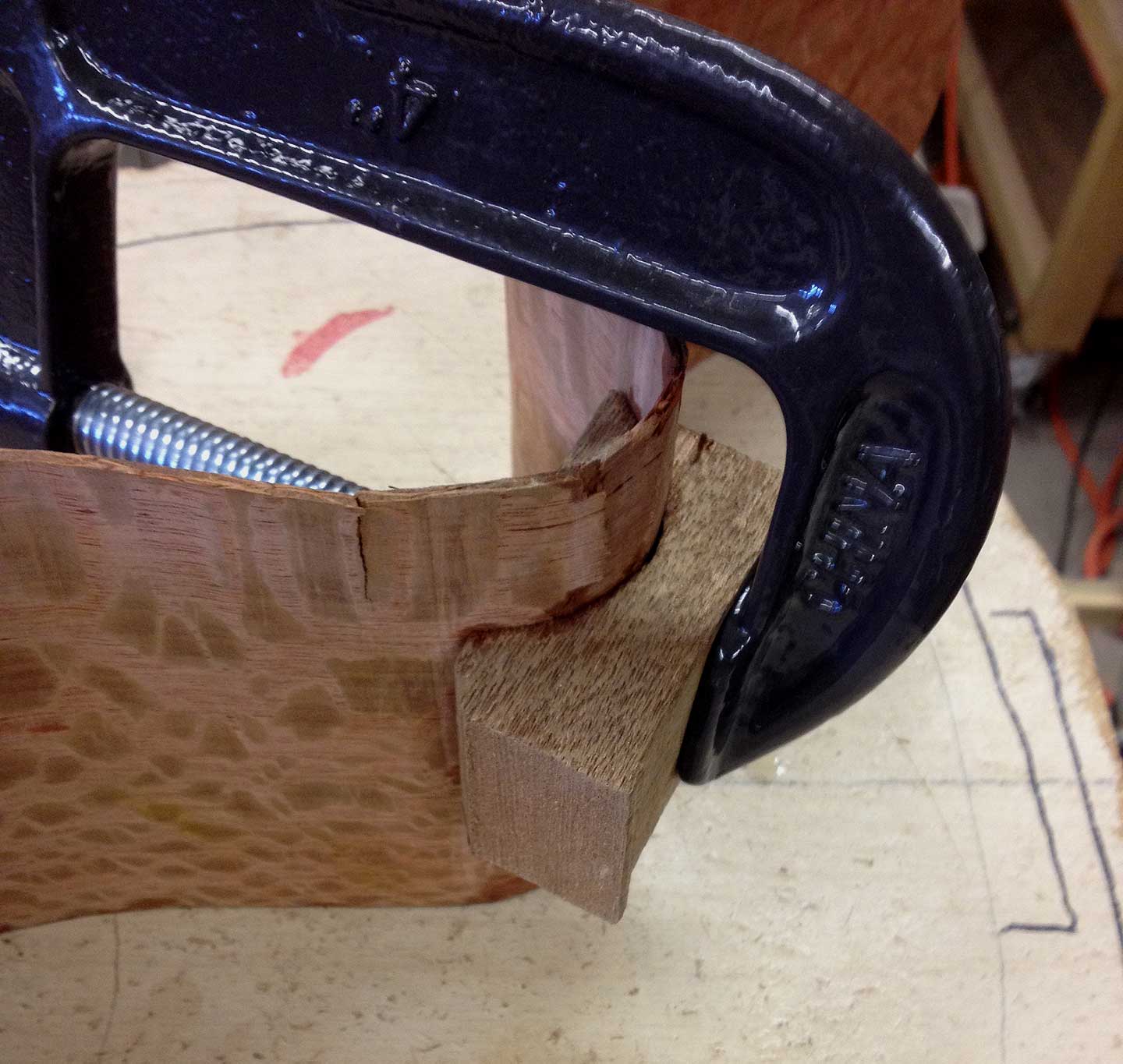

And then, the break.

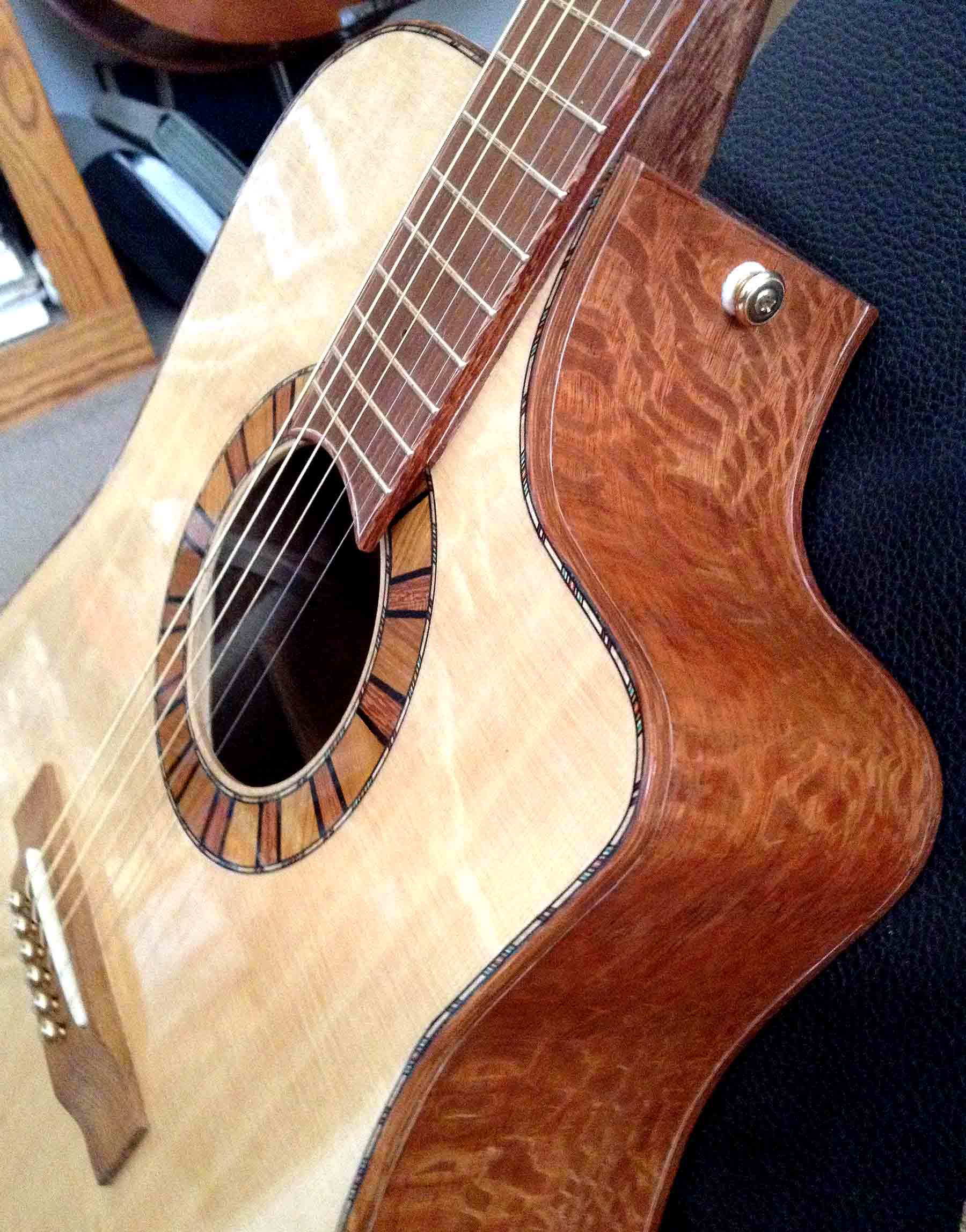

Hi Peter, thanks for showing off your latest creation. I must say that there is a noticeable increase in refinement of your builds over these four. Things like the headstock binding that matches the body purfling and rosette, the cutaway, the finer truss-rod opening. Very nice work. I am sorry that one of our Australian timbers gave you such grief - but it did end up looking very pretty. And the break at the cutaway bend actually finished up invisible. Nice recovery. I have never tried using lacewood, and you are making me a bit nervous about trying it now. I take it that you are still happy with this adjustable neck joint? I love how subtle that little hole below the 18th fret end up being. I certainly don't think the lack of a heel is anything detrimental. In fact if you ever wanted to play up at the 15th fret (which I never do) it is a definite advantage. So are all of there instruments hanging on your wall with that collection that can be seen in your photos - or have they found homes elsewhere?
Posts: 1322
Re: Acoustic/electric dreadnaught, adjustable neck
Thanks for the kind words, Mark. All my builds are for the learning experience, so these fit right in. I was able to try making rosettes, binding fretboards and headstocks, making cutaways, and doing top, back and side purflings (even though they didn't come out very well). I really like the adjustable neck that lets me dial in any action, and they will never need a neck reset. I made this last one for a friend I jam with - he's an electric player who uses the full fret board, and the cutaway and heel of this one let him get up there.

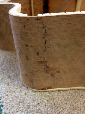

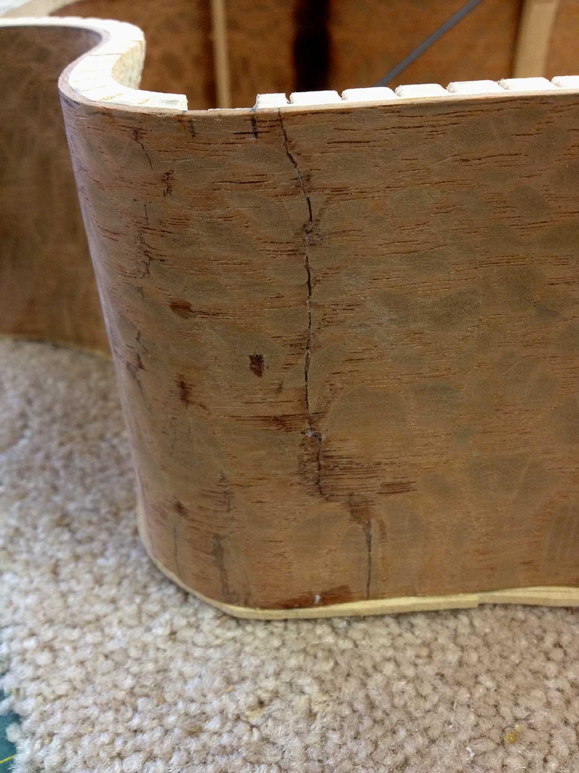

Nice, clean looking stuff. How did you fix the cracks?
