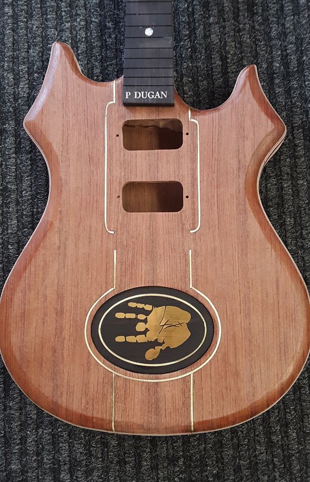

Well, here it is on a mandolin that I built and am now gearing up to build a guitar. This one is headed to finishing booth soon. I spoke with some other builders that make Irwin tributes and they all confirmed the key was a tight slot and CA adhesive. I've done three mandolins so far and each one is a little better than the last. Joints are much tougher than celluloid or wood binding to get matched up..

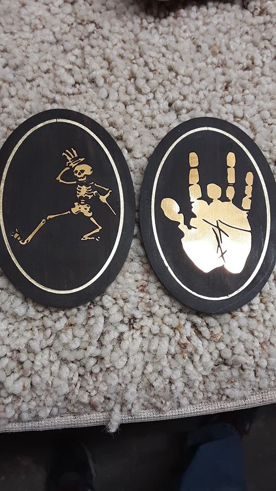

Andrew Jerman
Posts: 21
Joined: Sat Jan 07, 2012 11:00 pm
Re: Brass binding on Garcia tiger/rosebud
Post by Andrew Jerman »
Posts: 2690
I missed this thread before, I use 14kt gold-filled square wire in 1/2 soft for doing inlays. It's relatively inexpensive and it never tarnishes. CA holds it really well and you can buff it lightly but no heavy sanding or you'll sand through the gold layer. The base metal is bronze I think so it may well hold up better than brass. If you need lots of tight bends you'll want it in "dead soft".
