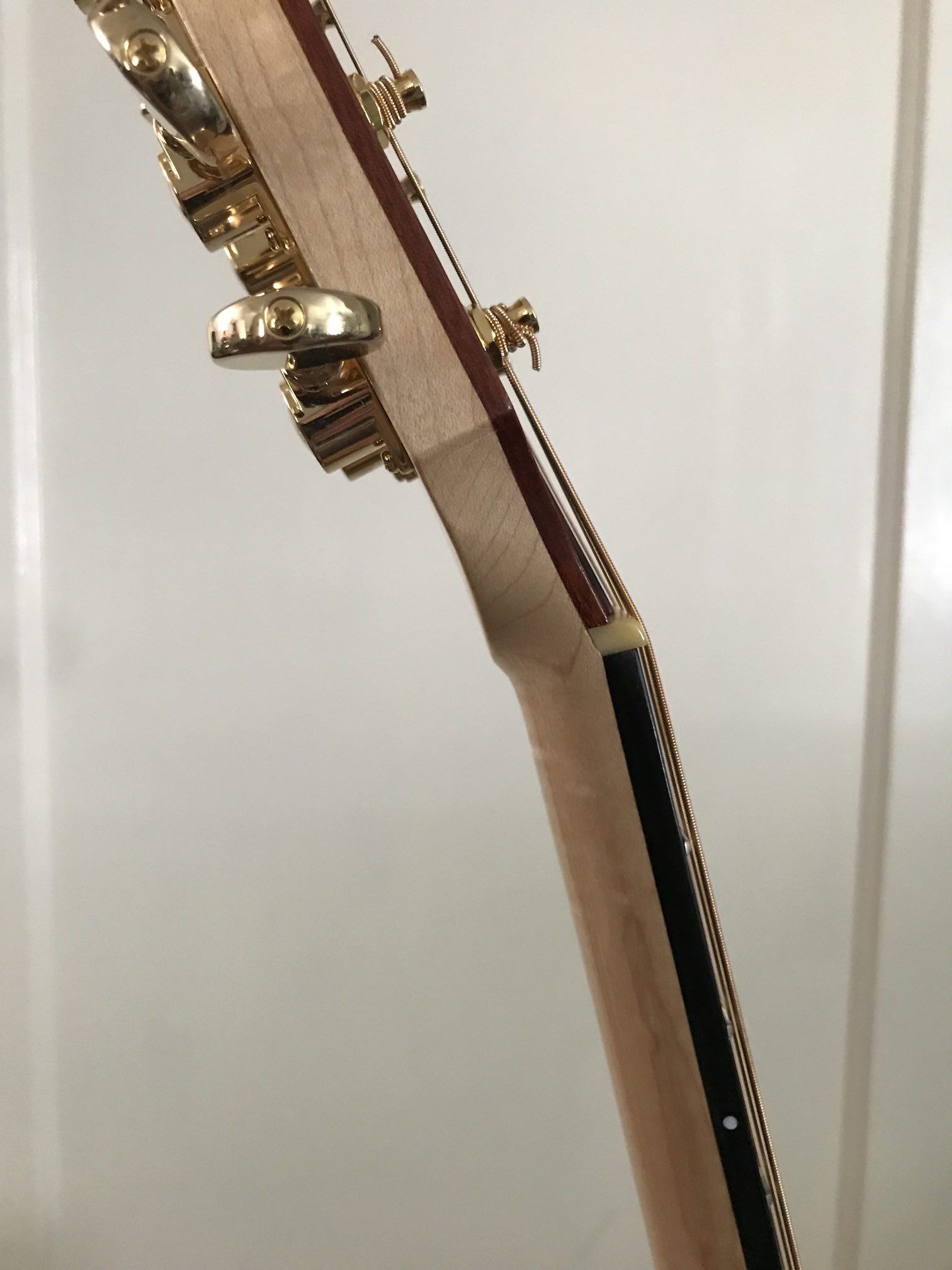

Postby Steve Sawyer » Sat Jul 13, 2019 1:10 am
I just finished carving my first volute in this Lester I’m building. Seems to be in a good spot, but I’ve never played a guitar with one, and don’t have another to compare to. When fingering a 1st-fret barre (F or Bb), my thumb sits right at the transition from neck shaft to volute. It seems to feel ok - not “in the way” - but not being fretted or strung, I thought I’d ask if that sounds right.
Thanks.

Postby Barry Daniels » Sat Jul 13, 2019 10:27 am
I usually put the peak of the volute right behind the nut.

Postby Barry Daniels » Sat Jul 13, 2019 6:19 pm
Holy cow! I think we have stumbled upon a consensus. This may be the first occurrence on the internet.
Posts: 2428
Re: Volute shape
Postby Steve Sawyer » Sat Jul 13, 2019 7:04 pm
Thank folks. I too put the crest right at the nut. Just trying to gauge whether the slope to the shaft is too long. From that side view above, it looks like I’m in good shape.
Glad I could ask a question leading to such an historic internet milestone!! :D
Steve Sawyer
Posts: 889
Location: Detroit, Michigan
