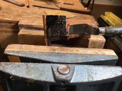

More heat gun on the end blocks to remove the remnants of the sides (will be reusing the blocks). Interesting discovery on the bottom block are three plugged holes indicating that someone had attached a tailpiece at some point in the guitar's life. Probably an interim step before the top was replaced.

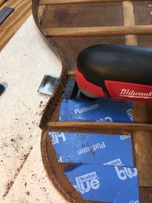

Using an oscillating saw with a flush cutting blade to remove the kerfing. It leaves just a bit of cleanup with a chisel and scraper.

sounds like the sides were fully oxidized through-and-through. there's no coming back from that. thing is, the back is probably the same so watch out!
