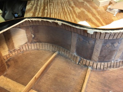

- Posts: 3254
Re: Restoration of a 1931 Martin 00-17
The rims are really in bad shape. Two full length spilts were previously repaired but are partially opened. Also, check out the large side repair near the headblock. I don't know what kind of wood that is. I do believe the sides are not worth saving.
The strange wood was also used to fill in the outside edge of the lower bout on the back. Will have to replace that with genuine mahogany. The two repaired cracks in the back appear to be in sound condition.
- Posts: 922
Spray gun and dark sunburst fixes all... I was taken aback to see the sunburst sprayed right over the pick-guard. That seems just kind of rude.
- Posts: 3254
Yep, the sunburst appears to be mainly for covering up the repairs using mis-matched wood.
