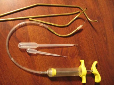

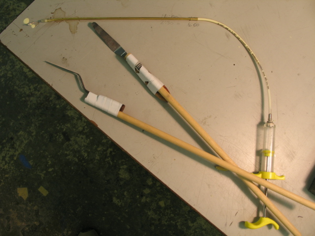

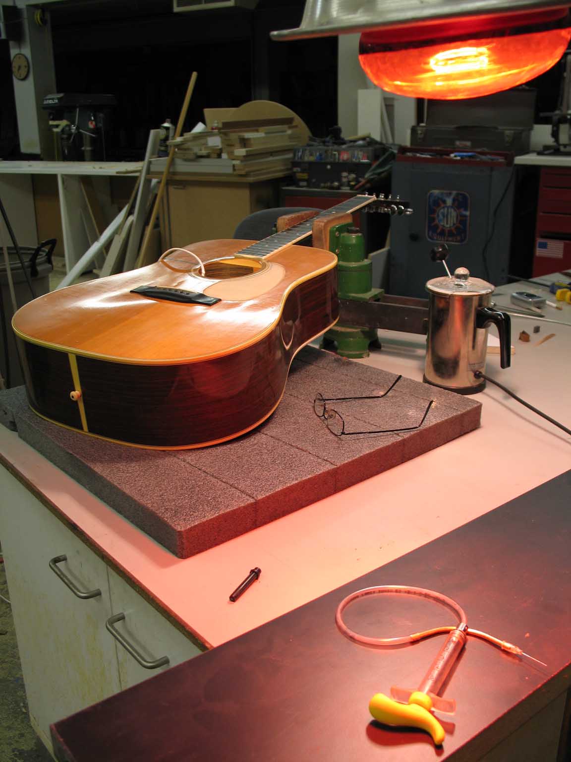

I put strips off acrylic mirror cut to fit through the sound hole and a light, so I will have a good view in there. That also serves to protect the back of the guitar from glue drips. I have used thin spatulas taped to a dowel rod with a dollop of glue on the blade to deliver the glue (repeat as required) and also use a hypodermic rig to get glue in hard to access places. You would also want a reaching tool with some cloth bound to it that can be dampened and used for glue clean up once the glue is applied. Titebond does a good job with a previously glued, dirty joint. I would probably use that unless this is a high quality instrument.
Palette knife glue delivery works best with Titebond but you could also use hot hide glue if you work fast. I have also had very good success with thinning the Titebond with water a bit and injecting the glue with my hypo rig. Hot hide can be delivered this way as well but the trick is to keep the glue hot once it's loaded in the hypo rig. I do that by laying the rig on a piece of Black laminate and heat with an Infra Red lamp. Infra Red will not heat reflective surfaces but the Black laminate gets quite hot and is sufficient to keep the hide glue hot in the rig.
The glue injector came from Stew Mac. I use plastic and Brass tubing with a hypodermic needle taped to the Brass tubing with electrical tape. The Brass tubing shapes are somewhat job specific, so I make new shapes and lengths to suite the nature of the work as necessary.
Hopefully the pictures will help explain.
