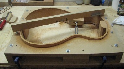

Jorge, as Alan said, the back (and tops) are usually more or less spherically domed which is kind of tricky to achieve without a radius dish. The method described in the StewMac instructions sort of works - I used it on my first couple of guitars. I just made a couple of sanding sticks long enough to span the guitar with 15 and 24 foot radii. There are some tricky ways to draw that curve - you can calculate it mathematically, tie a pencil to a 15 foot piece of rope and make a giant compass, or draw it with some sort of CAD or drafting program (which is what I did). Anyway here is a guitar in its mold getting the kerfing sanded.
That will put the correct angle on the sides but it doesn't take into account that at the waist the sides are actually taller because they extend more into the sphere. I broke down and bought a couple of radius dishes and I now sand the rims to fit the dish
You can see that the waist does not (yet) touch the sand paper, that means the more needs to be taken off the upper and lower bouts. (Many people leave the rim in the mold while they do this sanding - I find that hard to hold and so I just try to be gentle)
I always felt that while the first method worked, it did introduce a lot of stress into the back. The top has a much flatter dome so its probably not as critical, but I feel that I get a much better fit with the dish. I think if you try to visualize what is going on you'll have better luck fitting the back.
Good luck, hope this helps

Jorge, I think flat on the top is OK but remember that the back is not only domed but it tapers from tail block to the head, Normally the lower bout is about the same thickness but the sides taper significantly from the waist to the neck. I rough cut that taper into my sides before I bend them but I rely on the sanding to actually give them the compound curve shape. It also means that the back is in a compound shape - the back braces will give the side to side dome but it is the glue joint to the sides that makes the lengthwise arch. The wood wants to bend from side to side but will fight the lengthwise bend and it is possible to have some real stress points along that glue seam. I just wasn't happy trying to make that joint so I bought the radius dish.
You can do it for the first guitar or two but at some point you'll want to move to a dish.

If you're sanding your rims free hand, no mold, how do you keep your radius? If you flex the sides at all I would think that you would lose your radius, or at least make it wrong. I am always in my molds, and I draw a line to keep it in the same place in my mold, while I sand to ensure a good fit. If I can do it out of the mold that would be easier. (This is my least favorite step in all of guitardom.)
