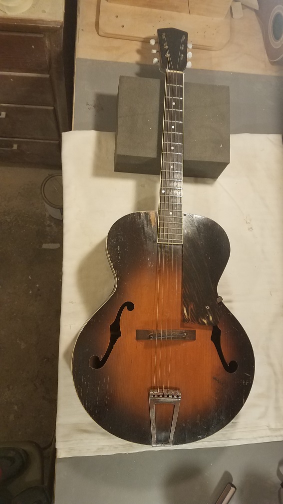

Well, I'm back at it. I got a chance to do some work on this guitar. I also decided to start over and make my cleats over again because I didn't like the shape of the the first ones I made.

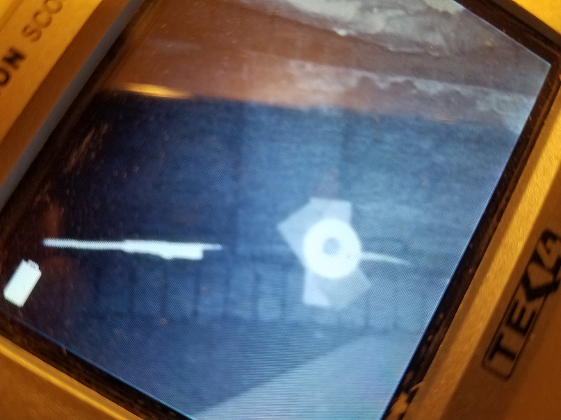

But First here are a few pictures to show exactly what I'm dealing with here: So, as you can see, the crack runs just about from tail block to head block and there is quite a bit of material missing. At some point a repair has been attempted, but that will need reversed and hopefully I can do this properly.
Here's a picture of the inside through the F-hole...
