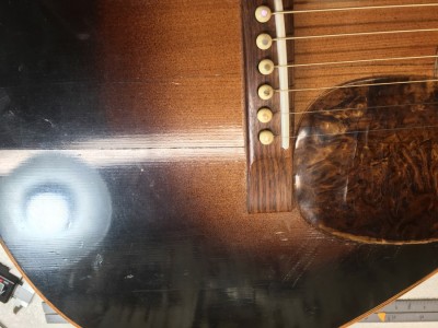

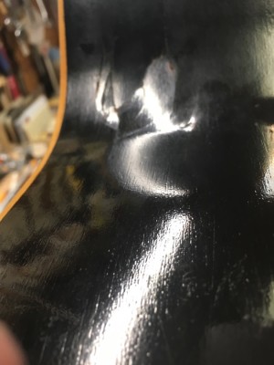

There are cracks in the top and back and some punctures in the sides that were covered with tape. And there is a crushed area at the waist. It also has very excessive neck relief (no apparent truss rod or reinforcement) and a decaying pick guard that is cupping the top.

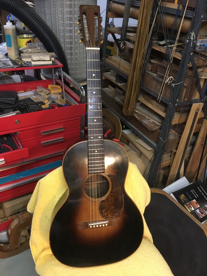

My client picked up this guitar at a good price on Craigslist and we thought it was a good investment, but upon closer inspection and a bunch of research we discovered that there were some serious issues affecting the collectibility and value.
An early 30's 00-17 should have a mahogany top, no binding, and no sunburst. It appears that someone did extensive modification at some point in the past, replacing the top with spruce, adding wood binding on the top and back, and applying a black sunburst that fully blacked out the sides. There was also a mention from a recognized expert that the neck may not even be the correct one and may have come from another Martin. I also observed a section of the sides near the neck that had been replaced. I think the guitar suffered major damage at some point and was rebuilt with no regards to originality.

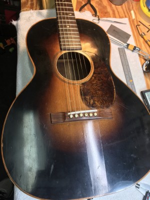

I formulated two options: repair or restoration
1) Repair the cracks, holes and crushed area.
2) Restore the guitar to as close to original as possible with a new mahogany top.
What is left out of both of these plans is a way to deal with the neck relief. Lacking any neck reinforcement, I think the fretboard needs to come off and rout in some slots for carbon fiber bar(s). The neck is so bowed that an adjustable truss rod alone would be insufficient to straighten the neck, plus it would not be appropriate to the vintage.
The thing I like about option 2 is that top removal would make the repair of the back and sides much easier and more thorough. Option 2 would also include removal of the maple bindings and replacement with simple mahogany binding that will hopefully not stick out like a sore thumb. Also, a refinish would get rid of the inappropriate sunburst. If the sunburst was a simple over-spray, I may be able to sand it off the original finish and salvage what is left. Otherwise it will be a full refinish.
According to the experts we consulted, the guitar has zero collectible value due to the extensive modifications. I will pause here for a day or two for questions/comments/suggestions.

Barry, those sides look pretty far gone to me.
After you get the black paint off, and fill the binding rout, and replace that crushed waist, AND replace the white-wood piece near the neck... there ain't gonna be nuthin' left.
I vote for new set of sides.

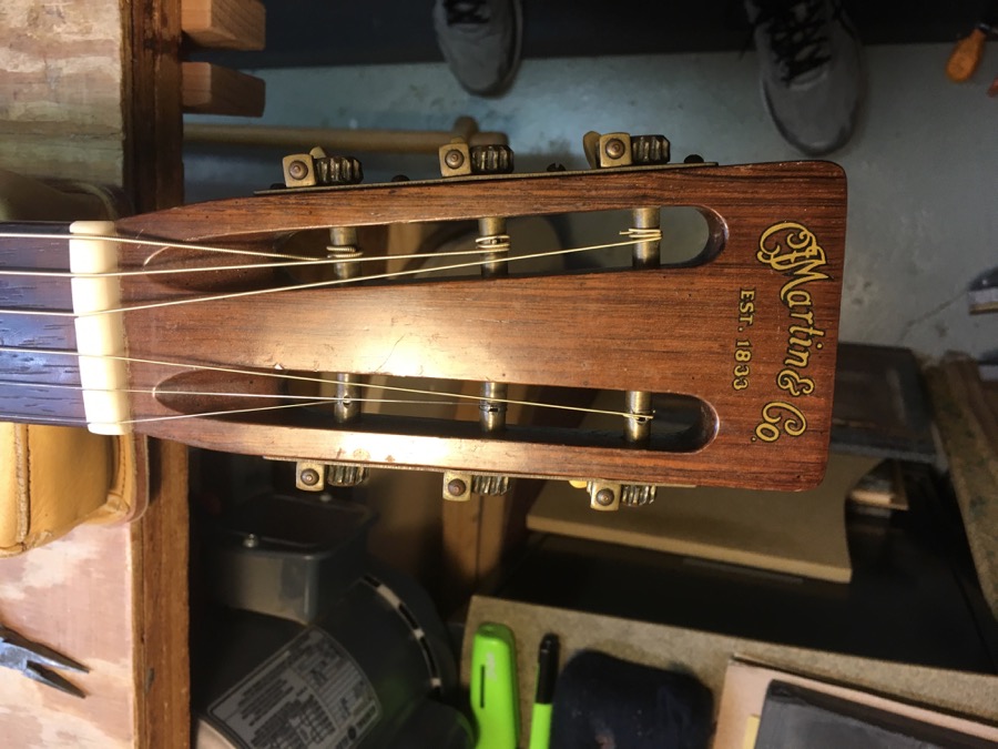

I found some discouraging things last night when starting disassembly. The fretboard had been cut off at the 12th fret, probably when the new top was put on. Also took off the pickguard and saw how poor of a top that was used. Also, sanded a bit of finish off that large repair on the side and the wood looks really light colored. Sort of already knew that but it really makes me question if I can save that repair. May be able to stain it but may not turn out too well. Chuck may be right about the sides.
Also, I found that the neck has an ebony reinforcement but it is super flexible. I can make the neck bow over a 1/16" by just pulling up on the headstock. Will definitely need to put in carbon to stiffen it up.
I am questioning if I should proceed or button it up and give it back. May be a lost cause.
