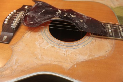

I'm working on an old Yamaha that has a big thick engraved pick guard (thing Gibson Hummingbird) that is coming off. It looks like it was attached to the top which was finished (doesn't react to lacquer thinner, must be some sort of catalyzed something). There is damage down to the wood in a number of places, mostly right along the edges of the p/b. I'm guessing someone tried to repair it at some point with unknown glue.

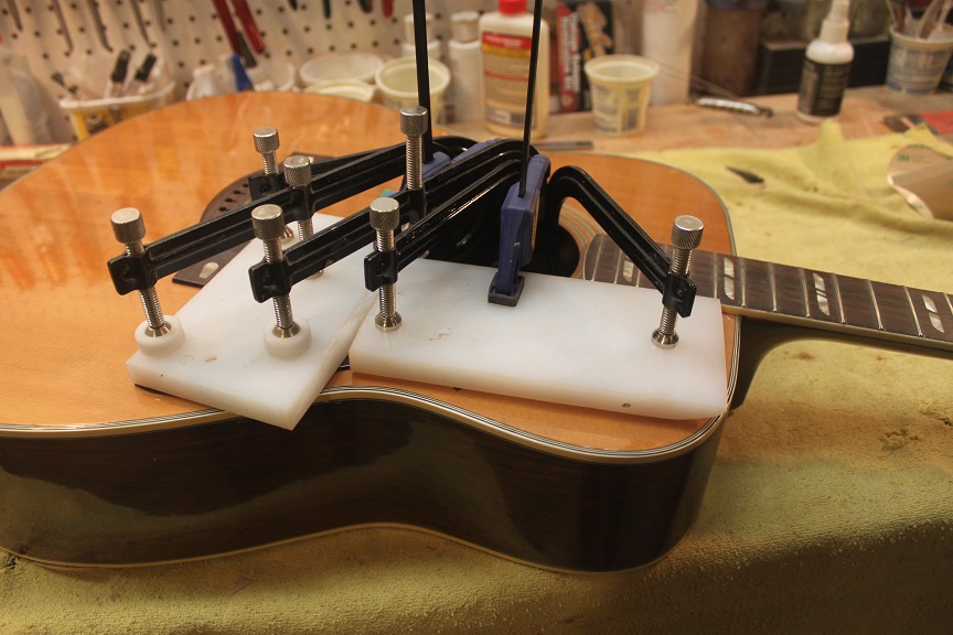

Got the p/g off and cleaned the old glue off of its (mostly scraping, naphtha didn't touch it). Cleaned up the top and brushed a couple of coats of shellac on the bare wood. Warmed the p/g and clamped it flat overnight. Put double sticky tape on it and attempted to reattach it. Came loose from the top after a couple of days.
Dilemma now is what glue to use. I know contact cement is sometimes used for p/g's but with the irregular and damaged wood I'm wondering if this might be a case for (whisper) epoxy. I can get good clamping action all around the p/g but I know I only get one chance. Thoughts?

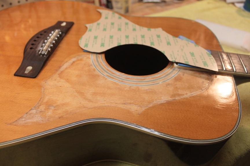

My tape was some generic carpet tape - it seems to be pretty tenacious - I used it on another pick guard but that one was nice clean finish on the guitar and a clean new p/g. The top of this guitar is pretty beat up, down to and into wood in a number of places, most of which are right at the edge of the p/g. I am now trying to drop fill them with some superglue and I'll try to scrape that back level. The fact that the p/g is quite thick and is somewhat warped doesn't help - I did heat it with a hot air gun and clamp flat but it still has some wave. I think I'll go ahead and order the StewMac 3M tape and give that a try.

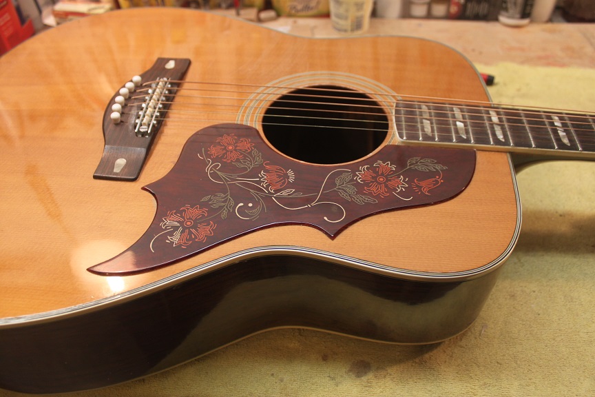

I flatened the pickguard as best I could, built up the damaged areas with CA and leveled back to the finishing and reinstalled the p/g with the 3M sticky tape. I also told the owner that it might not last and we would have to consider a plan B.
Posts: 583
Re: Adhesive for pick guard
It looks great! I see why it wasn't a simple substitution.
