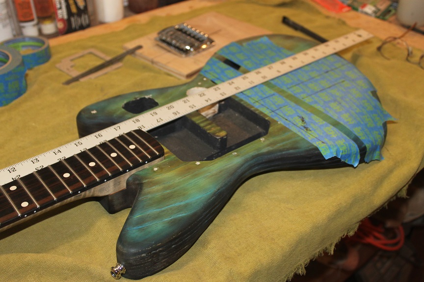

Postby Freeman Keller » Tue Mar 12, 2019 11:30 pm
Guitars have all gone away so I can't take any more pictures but I can share the ones that I have. This will be a combination of the best of each guitar so don't get nervous if the colors keep changing.
First thing, like any guitar, the geometry is critical. All three of these were Warmoth bodies and necks in the classic Jaguar-Mustang configuration. Kahler has very good instruction on their website for location and making a routing template - one thing they are adamant about is that fret plane be 0.500 +/- 0.020 off the body in front of the bridge. Apparently Jag-Stang bridges are 5/8 thick (according to Hiscock) which means I had to shim each of the Warmoth bodies to get the proper neck angle. 0.5 degree shims put me in the ball park.
Like any other bridge, you lay out the centerline based on the sides of the neck and mark the scale length
Kahler gives all the measurements to make the template. As I recall I used 1/4 inch for corner radius, drilled them with a 1/2 inch bit and just connected the radii. Very straight forward.
The one thing that is not straight forward is that Kahler has what they call "critical contact point" where you locate the scale length. It happens to be the mid point of the saddle intonation travel. I questioned this, particularly since they call it "critical", so after meditating for a few moments, I called Kahler. I'm quite sure I was talking to Gary Kahler, I told him as an engineer how impressed I was with his bridge but wondered why he located it where he did. He kind of shrugged it off and said that was to cover all of the bases - I said I couldn't see any reason anyone would want "negative" compensation (towards the nut), he said there was lots of travel so it really didn't matter.
Long story short, I moved the critical dimension 1/16 away from the nut and marked that on my template.
I don't trust double sticky tape to hold a template in place so I counter sunk two of the flathead mounting screws into the template and screwed it down. Clamped the whole assembly to the work bench and made some sawdust.
Drill a hole into the electronics cavity for the string ground and, bingo!
Kahler doesn't give you a screw for the ground, I just fanned some stranded wire out under the bridge when I screwed it down.
Kahler has three videos on line, the first two cover setting up the bridge (the third is for stud mounted bridges). As I've said before, I think the mechanism is elegant but you need to follow the steps. There are basically three parts - the string retainers and fine tuners, the saddles which adjust up and down, in and out and side to side, and the whole tremolo thing (which is why we are here in the first place). The string balls drop into little retainers (am I the only one that thinks cutting them of is, well, kind of stupid?), and you center the fine tuners. Adjust the action height (one 440 screw per saddle, adjust the intonation ( a separate screw, move them back and forth) and set the spacing (the same screw that locks the saddles in place when you are done). The a separate set of adjustments for the tremolo - one screw locks/unlocks it (how many trems have a block of wood in them) and one set screw balances the string tension vs the amount of climb or dive on the bar. If you change gauges or tunings its relatively easy to rebalance the travel. The bar screws in and out (there is even a hole for left handed).
It uses a pretty normal locking nut - all three that I've done had Warmoth necks with the locking nuts installed. Kahler sells their own, installation would be the same as any other (route the end of the fretboard, drill a couple of holes thru the neck (missing the truss rod) and bolt the thing on. I don't like locking nuts, I think they are a hassle, but it works and, more importantly , the fine tuners work.
