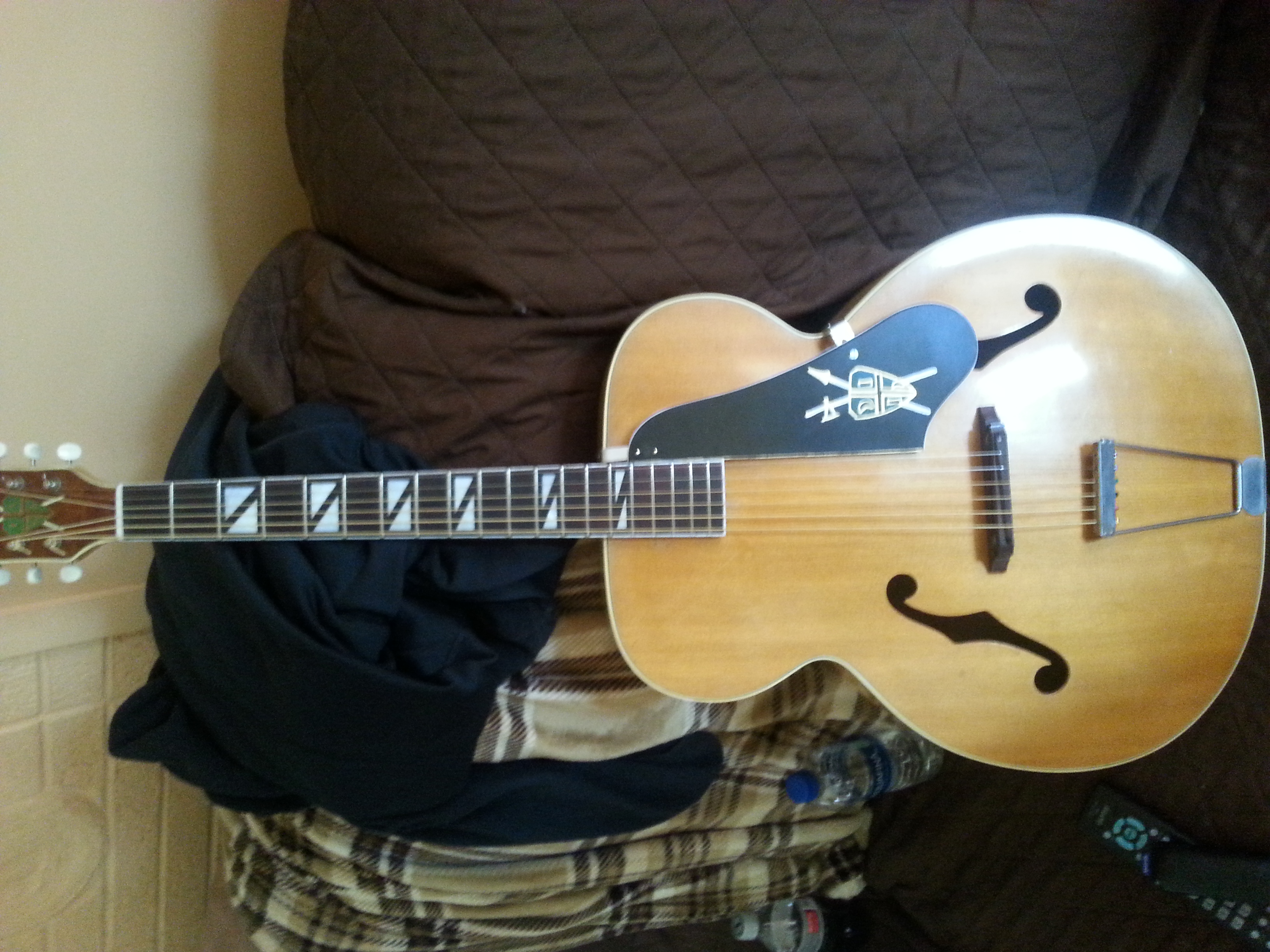

I tried to avoid a refret but, after leveling and having some really low frets, I had to do it. Leveled the fretboard and replaced the binding. It was very thin and brittle. Made a new nut and bridge base, as the old one was way too low to work after the neck reset. Oh yeah, also fabricated a pickguard modeled after pics from the Silvertone world website. Had a friend with one of those vinyl label makes print off a shield like the one on the headstock, then colored it to match.
Anyway, it's all done now and it sounds and plays great. I actually think it sounds better than the archtop I made myself :oops: . Next I'll try to tackle the case, which has an unattached top. Don't really know how I'll do that but I must figure something out.
I don't know how to rotate the pics, so they're a bit confusing.
