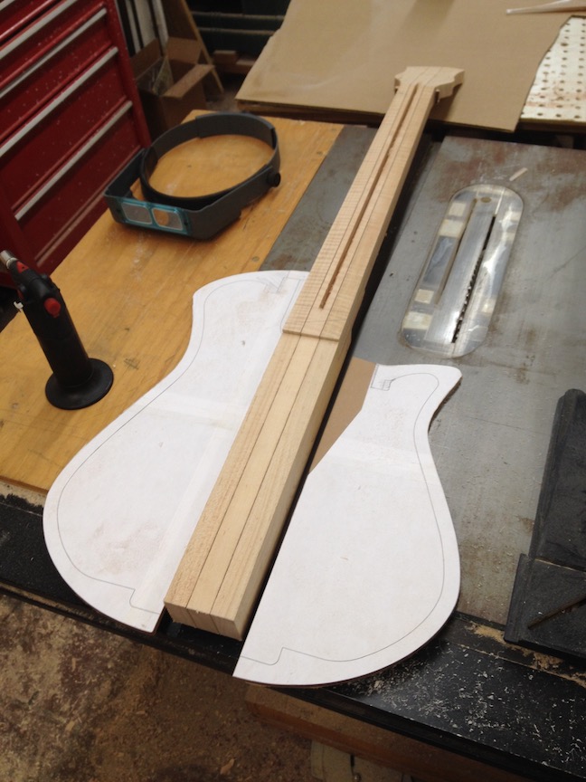

I like to use flat sawn maple (cheap bugger) and laminate a dark veneer as an accent on my neck through guitars. I bury the body section in a quasi hollow body ala Danelectro. I angle both the headstock and the neck to body point.
