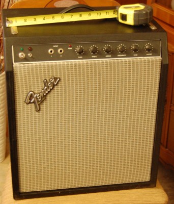

Postby Daryl Kosinski » Sun Sep 30, 2018 11:38 am
Building a new Cabinet is not that hard. I built myself a franken Fender out of a old Deluxe and Sidekick 65 bass.
Spray on truck bed liner makes a great covering. Here is before and after.

Postby Daryl Kosinski » Sun Sep 30, 2018 11:41 am
Here is the after

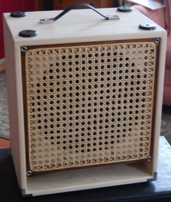

Re: Amp restoration
Postby Daryl Kosinski » Sun Sep 30, 2018 11:45 am
When I play Bass I use this Cabinet with a 15 in speaker. I unplug the 12 in the cabinet and plug in the bass cabinet.
Here it is before the spray on covering. The cane grill was some leftover from a chair project turned out cheaper than Fender grill cloth.

Postby Daryl Kosinski » Sun Sep 30, 2018 12:07 pm
I also added a tweeter to the 12 in cabinet.
