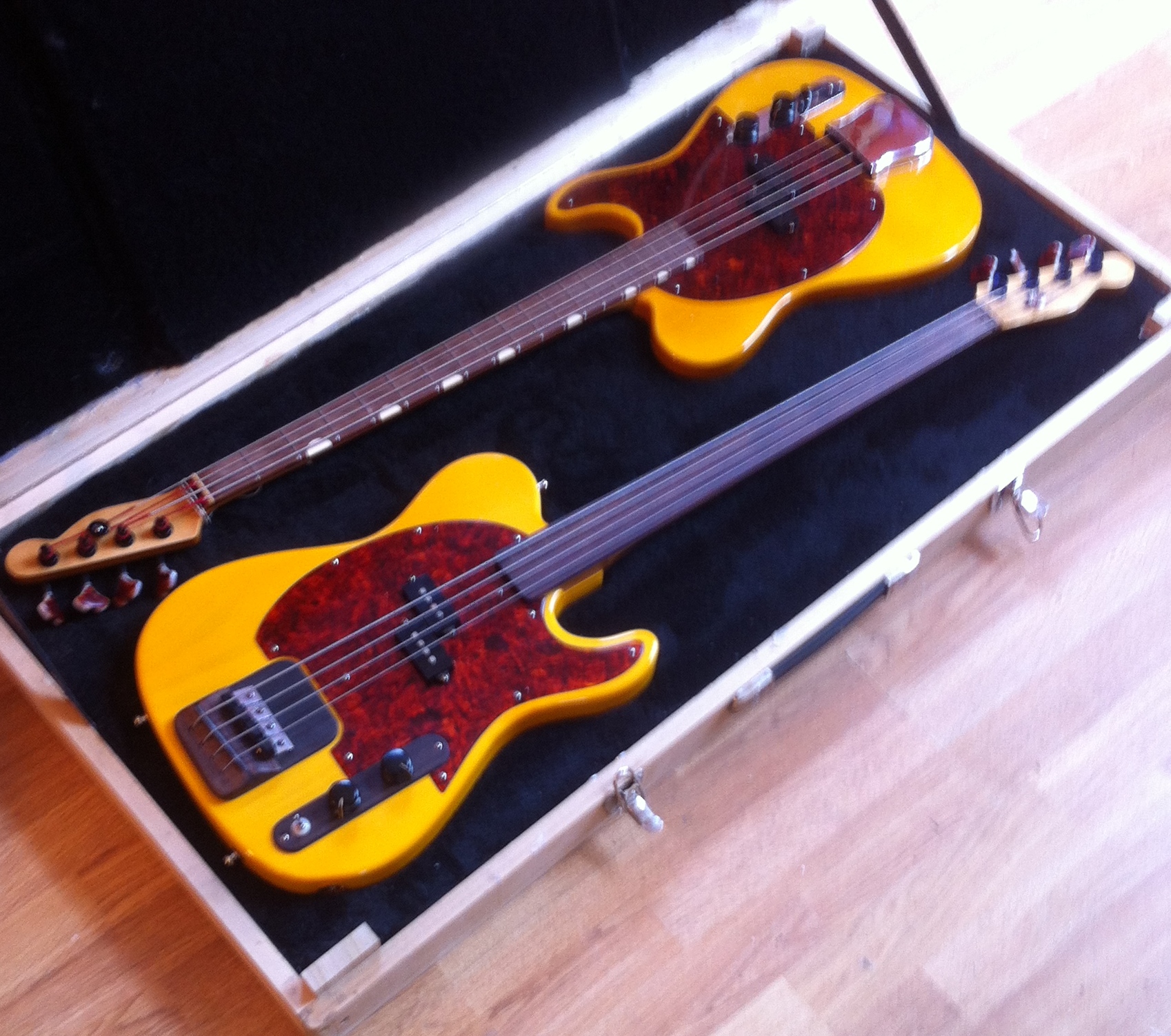

I enjoy short scale basses (30") when they work. Some do and some not so well. I've even done a number of guitar conversions using a 25.5" scale for the children of friends with moderate success. I wouldn't advise a low B on any build under 34". A few years ago I built a pair of basses for myself (fretted and fretless) with ash bodies in a telecaster guitar pattern. I purchased a pair of baritone conversion necks from Warmoth and had them made without holes for tuners and without fretslots or markers. Unfortunately, they got the order wrong and I received them with the headstocks drilled for six tuning machines and had to send them back -- no hassle, just a delay. By mounting the bridge far toward the bottom of the body, I was able to achieve a 33" scale. I re-profiled the length of both necks narrowing the width at the nut by almost 1/4" in total width putting the string spacing at the nut to more like that of a guitar. I used the fret calculator at stewmac to determine fret positions. I find that the 33" scale fretless is far easier play than any 34" scale fretless I've encountered and like you, I've never done formal bass lessons. The focus of this project was to have fun and end up with a unique pair of basses that would be just for me. This was a really fun and rewarding adventure and I play out with these when ever I can. I'd just recommend that you write down your priorities of what you want to accomplish and go for it.
