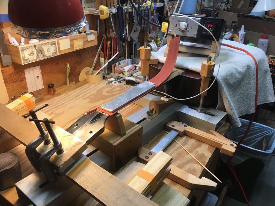

So the repair plan for the neck that I formulated is to:
1) Heat set the neck and fretboard to get them into a straight position without twist or excessive bowing (I forgot to mention that the neck is also bowed up about 1/16").
2) Rout slots for two carbon fiber bars and install them.
3) Get rid of the original compression rod (the cause of all this mayhem) and install a modern dual-action rod because this will cause no additional compressive forces on the neck.
The guitar goes into my "Teeter Neck Compensation Jig" with a long board clamped on the peghead to unwind the twist. Some heat from a heat blanket and the twist is taken a bit beyond straight and then allowed to cool. It came out pretty straight. I am going to take a break and get back to the shop now. Feel free to post any questions or comments. I value your input.

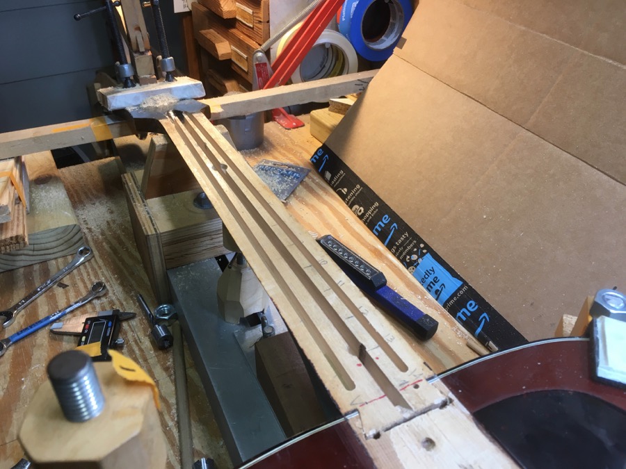

Now to stabilize the neck with the following:
1) A dual action truss rod made by Mark Blanchard. These things are top notch.
2) Two carbon fiber rods sized .2" wide and .25" tall from Dragon Plate.

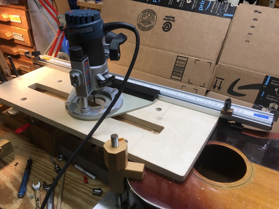

This will require cleaning out the old truss rod slot and cutting two new slots for the carbon fiber. Then maple splines will be glued on top of all three. My plan on the carbon fiber is to flare them out near the body so that they provide some resistance to future twisting. Also, I plan on placing the carbon fiber slots to cut into the neck lamination joints up near the peghead transition to lock these two questionable joints together. I will use West Systems epoxy for all of this and will add chopped polyester fiber additive to get as much strength as possible. Since the placement accuracy of the slots is critical I needed to remake my truss rod slot jig.
The jig was made with a piece of 3/4" baltic birch plywood, some toggle clamps to hold it to the neck, a Woodriver edge clamp and router plate, and a small plunge router. Once the base is clamped to the neck, the edge guide can be precisely manipulated to place the slot accurately.
Posts: 2263

The jig took me a few days to build and about 30 minutes to use. Here are a couple of more photos. I added some small stops in the T-track to control the start and end points.
The back of the jig was routed in areas to clear the pickguard and the bracket on my string compensation jig. The jig also has four sliding stops that I butt up to the neck to keep it from slipping. Strips of 100 grit sandpaper were glued on both sides of the big slot to further prevent slippage.
Posts: 2263

The slots turned out really well, much better than my old jig which was a pain to adjust.
The truss rod re-slotting was a bit fussy. The original slot had a curved bottom and the new rod needed a nearly flat bottom. So I lowered the slot carefully to prevent over thinning. I used a round bottomed router bit because the original slot was also round bottomed. I ended up only taking a bit of additional wood from the bottom of the original slot at the lower end, and even less wood up near the peghead in my goal to get the slot flat. I stopped as soon as I got close.

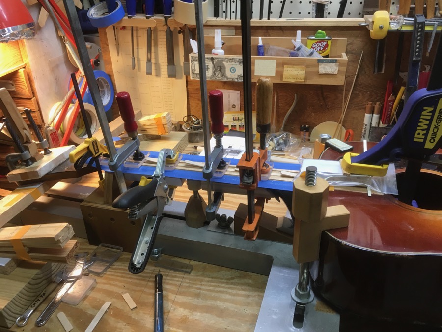

I glued all the stuff in one swell foop. I placed a small jack under the middle of the neck to remove the slight bow, and I still have the neck twist controlled during the slot cutting and the glue up.
The small popsicle sticks are small wedges to place clamping pressure on the truss rod filler strip which was slightly lower in elevation than the carbon rod filler strips.

Postby Barry Daniels » Sat Sep 15, 2018 11:55 pm
This morning I removed the clamps and planed down the filler strips a bit. The neck is much more stable as determined by twisting the headstock. The neck twist is actually a tiny bit in the opposite direction than when the guitar came in. I am OK with that and will deal with it latter.

Postby Gordon Bellerose » Sun Sep 16, 2018 12:01 am
I have a couple of thoughts...questions.
Would the jig be simpler with a guide bushing set up? Don't get me wrong, there is no wrong way as long as it works!
On second thought, I realized that with the thickness of the jig, the bit would be sticking out a long way if a guide bushing was used.
Do you think you will have to do something with the neck laminations separating?
Or do you think the heat from the blanket loosened the glue enough for it to reset?
