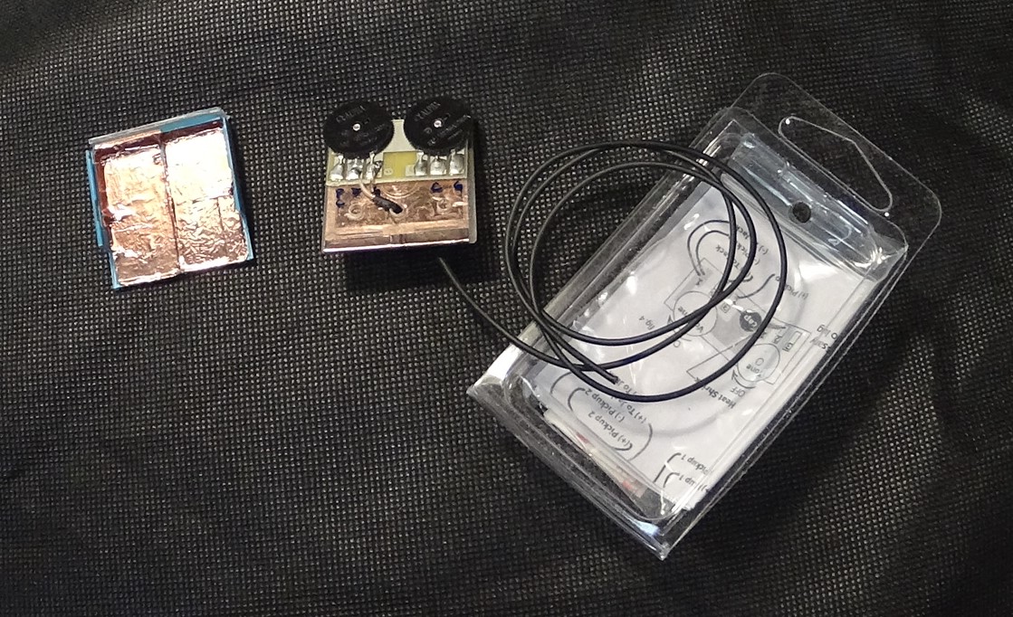

I have been using Schatten thumbwheel pots purchased through StewMac and installing them on the inside lip of the bass side F-hole. They sell a kit that includes the capacitor (of course you could swap cap out for another preference).
https://www.stewmac.com/Pickups_and_Electronics/Components_and_Parts/Potentiometers/Schatten_Thumbwheel_Controls.html
For my most recent installation I installed the pots in a modified plastic box, shielded with copper tape:
With the guitar completed, they look like this:
This guitar is actually a stereo output. A surface mounted StewMac Golden Age humbucker is wired to the tip and using the thumbwheel pots. The ring connection goes to JJB piezo transducers. I removed the HB pickup legs and mounted to the front plate using heavy duty exterior grade mounting tape with no window cut in the plate for the pickup:
I setup and play my builds in the white, make adjustments, then disassemble for finishing. I did not notice a big difference in acoustic tone with the humbucker surface mounted. I assume it is because the humbucker is basically right above the upper arms of the X brace and this area of the front plate is not a big contributor to volume or acoustic tone.
