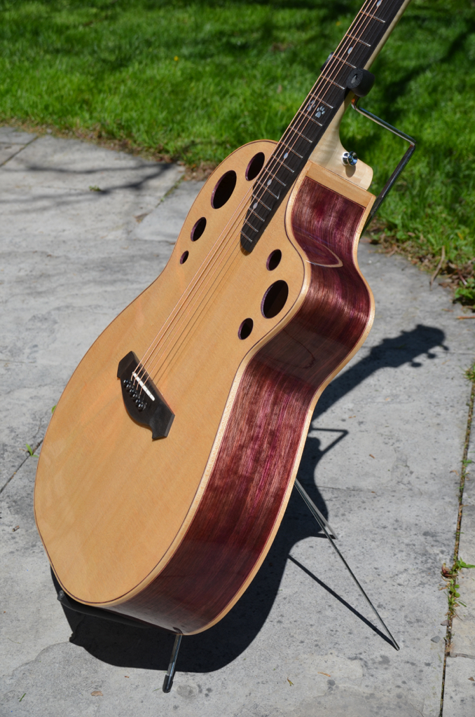

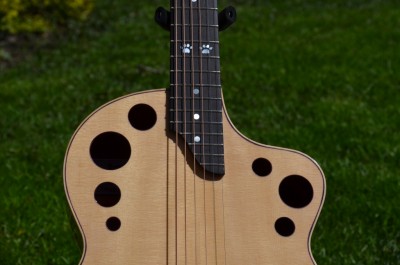

This is one of two guitars that I've been working on over the winter and the first to be completed. Body is purpleheart and curly maple. Sitka spruce top. Curly maple neck. Ebony fingerboard and bridge. Scale length is 24.75". The customer is a young woman who loves purple, hence the choice of woods. I did attempt to impart a bit more of a feminine look with the pink and purple purfling as well as the MOP-like tuner buttons. She has two cats that she adores so I added a couple of cat paws at the 12th fret.
It's always a treat to string up a new guitar for the first time and hear what it sounds like. I'm happy to report that this one, surprisingly, sounds pretty much like a guitar!
Enough talk. On with the photos...

Really nice Andy!
Those sides look like ribbon candy.

Well done! I’m sure she’ll be pleased.

Very nice! The colors are really well done.
The purfling sets it all off nicely.

nice execution.

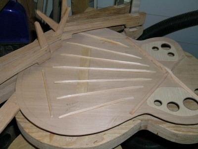

Would you worry about splitting at the rosette hole?

Matthew Lau wrote:Would you worry about splitting at the rosette hole?
Yes, that's a potential concern. Not shown in the photos I posted of this guitar, but a thin veneer layer would be glued on the underside of the soundboard around the sound hole area. Photo below is actually of a different guitar but with similar sound hole layout.

Purple Heart really works well with the Maple, especially the neck. Nice.
