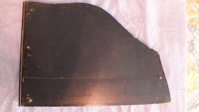

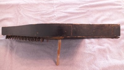

I just got my EBay purchase yesterday, a Zither. I am guessing it is a Schmit re-issue, possibly a Phonoharp 4/30 (No. 2 1/4). The label inside calls it a Mandolin Harp. I guess there are all kinds of Zithers.
What I hope is that things aren't too far gone with this instrument, and that I can effect repairs on the cracks that I have found. Unfortunately it will require me to somehow remove the back in order to access the front and back panels to glue the cracks, and install cleats. I also will need to determine how to fill these cracks without causing harm to the outside of these panels, and ruining the artwork that still remains on those surfaces. Actually, there is probably a ton of stuff that needs to be done to restore this instrument to workable, and hopefully nicer looking condition.
I am going to take so pictures of all the surfaces now, so will post part two in a bit. Caley Ann Hand

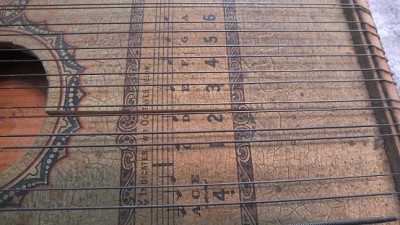

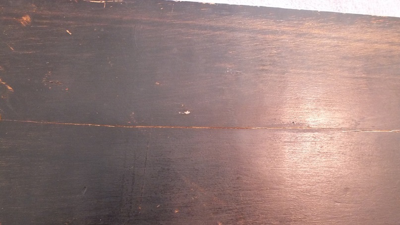

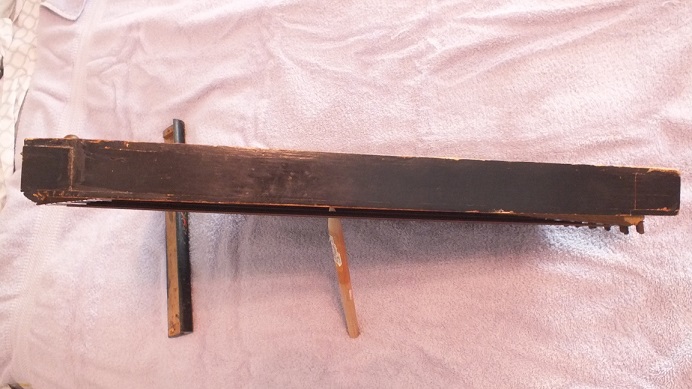

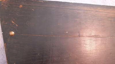

Postby Caley Hand » Sat Jun 30, 2018 7:11 pm
Just got some pictures roughly processed. Now that I have a higher resolution photo of the front crack, it may not be possible to completely close that crack. I may be able to get it mostly there, which would help. I will have to await the experts opinions.
Unfortunately this Frum only allows low resolution photos, so I am not sure the problems will be visible to those examining them. Sorry Caley Ann Hand

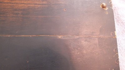

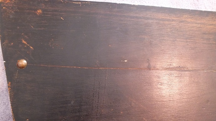

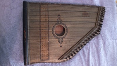

Postby Caley Hand » Sat Jun 30, 2018 7:12 pm
And the last batch

Postby Caley Hand » Sun Jul 01, 2018 1:47 pm
I am not a happy camper. I just removed all the strings on the instrument to get a better view of it.
What I found was another crack, though very minor above the sound hole matching the placement of the lower monster crack.
As for the monster crack, I doubt it can be brought together without taking the whole instrument apart. In other words, the front and back panels would have to come off in order for me to force the panel halves where the cracks are together. I did add a clamp on either side, and gently tried to squeeze some movement of that monster crack, with absolutely no movement, thus the talk about dismantling the whole instrument. The only other thing I could do is somehow insert wood or filler into the crack, but I get the feeling that is the wrong thing to do.
I have no skills when it comes to restoring musical instruments. This is where I try to get my feet wet, and it seems I picked a real winner to get started
All the tuning pegs are solid. The other end of the strings, those pins are OK except that some have been forced sideways.
Whomever had this instrument also did not know how to string it, with six and seven loops around the tuning peg, and in a couple of cases, the strings going to the wrong tuning peg. This is from me, someone who doesn't know squiddly about musical instruments, other than my reading, and of course, watching videos
Can someone tell me how I can clean the front with the decorative painting or maybe it is a large decal, without causing damage. I would just like to remove the dirt. I would also like to put some kind of protective coat on it.
I also would like to clean up the original tuning pegs. They look pretty good, but look like some kind of cleaning might make them look nicer.
Of course, doing the pegs and front cleanup are things that have to happen after I tackle the cracks. I think the back can be worked with, but the monster crack on the lower front is bothersome. Maybe someone can suggest a way to make it look nice. I am guessing that if I add cleats there, that may prevent furthur spreading of the crack. I just need help to find a way of making the instrument presentable, instead of the junky state it is in right now.
Thanks for listening to me blab. Maybe I will learn things eventually. Caley Ann
