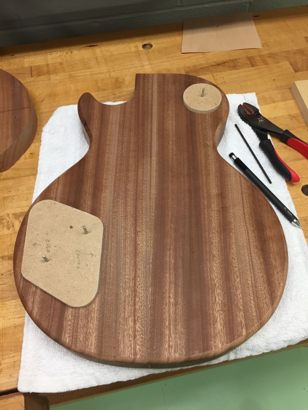

As I promised to Freeman, here is the method I used to rout the control cavities. As I mentioned, this seems to be very involved, but I have to say that the results were better than I'd expected.
First, I should mention that when I did my first build (a Telecaster copy) I made extensive use of 1/8" stainless steel dowel pins and 1/8" doweling run through a quick-n-dirty doweling plate for alignment. This was in part because I made a template that not only included the pattern for the outline of the body, but also for the neck pocket, pickups and control cavity, all of which turned out to be a mistake. However, I really like the ability to guarantee that the templates always go on properly aligned, so I continued this practice with this build, especially since I am doing a chambered body, so every piece in the "stack" for the body would be properly aligned along with the caul I made for vacuum pressing the whole thing together. Gotta love aircraft drill bits! :)
I placed bores for alignment pins at the center of each of the four control pots, the dead center of each pickup rout, and the location for the pickup switch. I only carried two of the four holes for the control pot shafts through to the back out of laziness if nothing else.
The next step was to make a pattern for each of the control cavity covers out of MDF, carefully cut and smoothed so they are exactly the shape desired. Each of these pieces also had alignment pin holes so that they could be placed accurately onto the body.

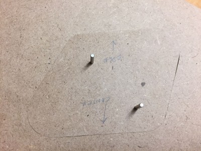

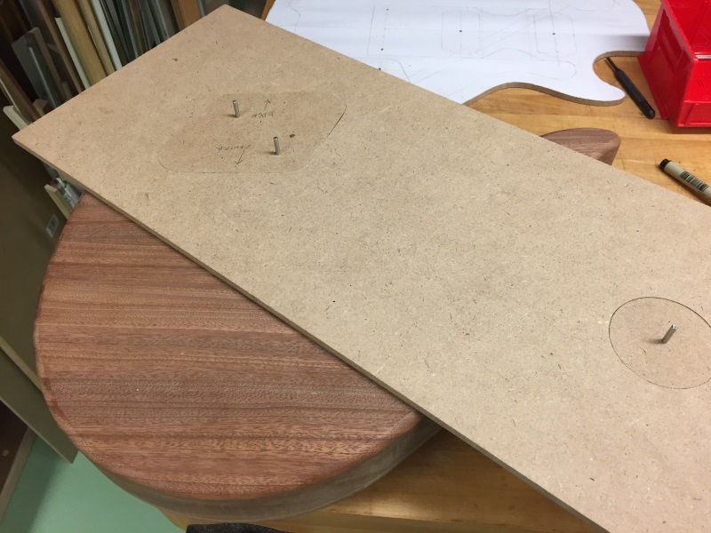

Clamping the original pattern on another piece of MDF long enough to encompass both cavities, I used my favorite hand-drilling jig to place the appropriate alignment holes.
Placing the patterns for the covers onto this piece of MDF, I traced their outline with an extremely fine (03 gauge) drafting pen (I have a whole set of these and LOVE using them in the shop for marking).
