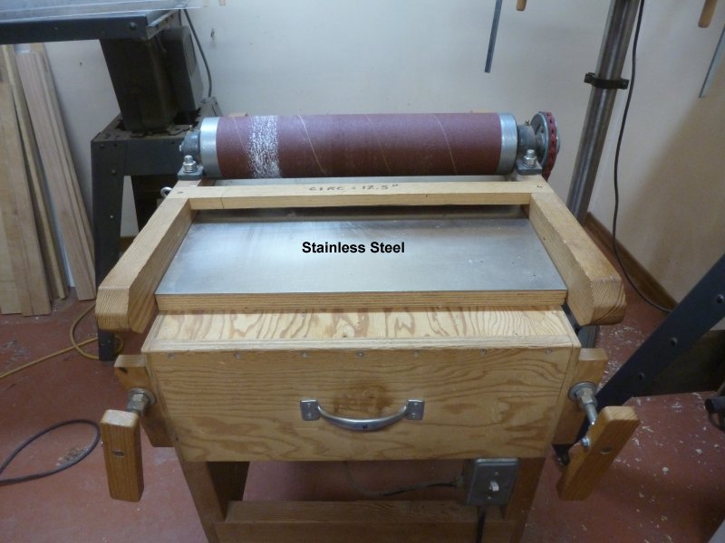

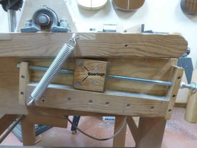

Back in the old days here on the MIMF, there was a lot of talk about making thickness sanders. I read all the threads in the library so making one just seemed like the thing to do. I made mine out of mostly junk that was already lying around. I still use it to this day. It is a perfectly serviceable option for me because I am not trying to turn out a ton of production. A purchased sander would certainly be faster and probably less tedious/frustrating. But, I wouldn’t be able to afford a 25” wide drum and be able to run plates through sideways to get them down faster. It sure sounds like I am recommending building one; I’m not. I’m really glad I have mine but wish I had invested the time I spent making it into but losing up my chops thicknessing with hand planes. Now that I am more comfortable with hand planes, I could probably take that next step but I don’t. I can’t bring myself to thickness with them because the sander seems more convenient. In truth, the time would probably be about the same but the planes would be more relaxing and less messy.

I built mine 25 years ago at a cost of under $250. I've made over 100 guitars with it. I find it incredibly useful. Each 1/2 turn of the screws changes the thickness by .05mm. It doesn't have an automatic feed and I prefer the additional control this provides.
