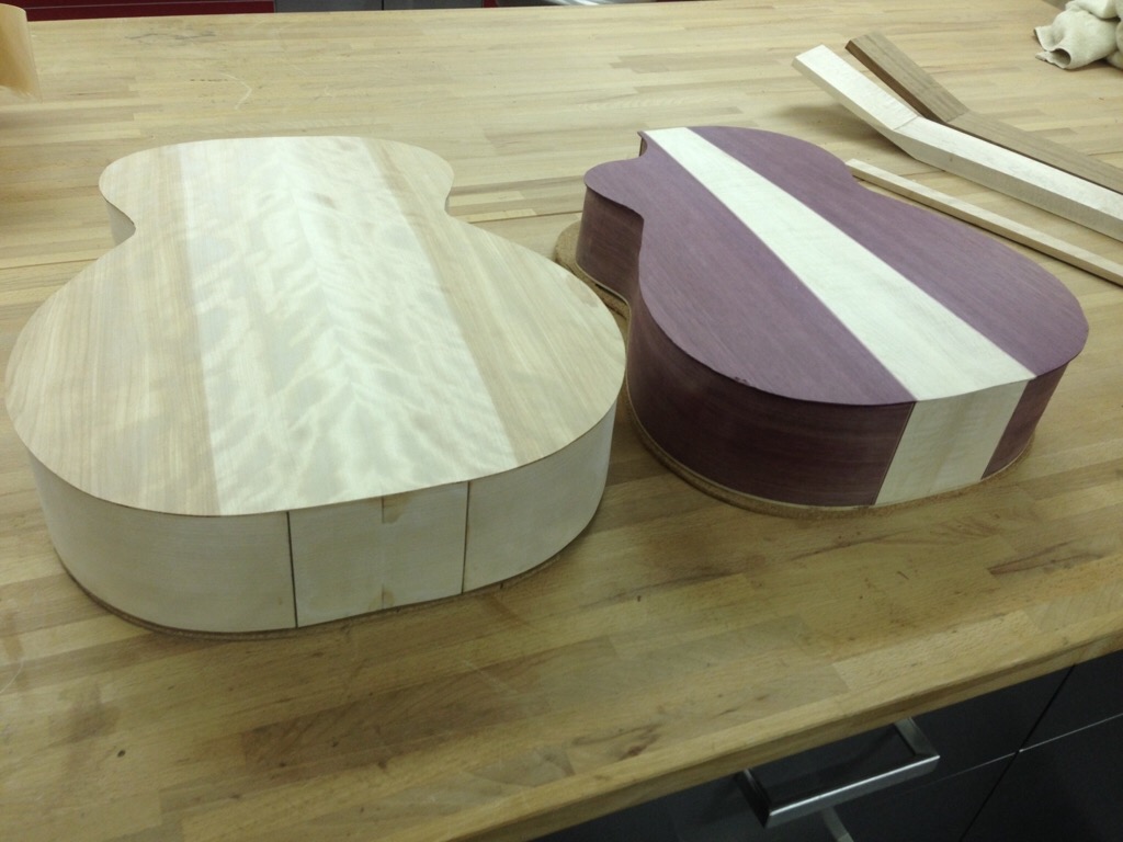

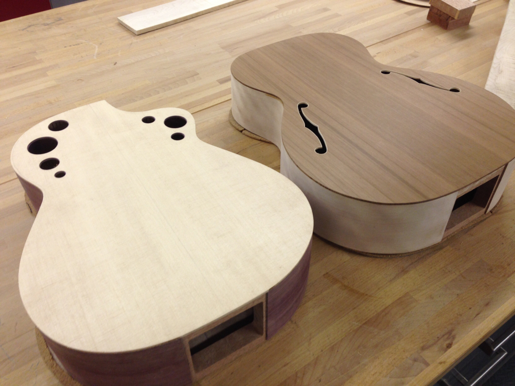

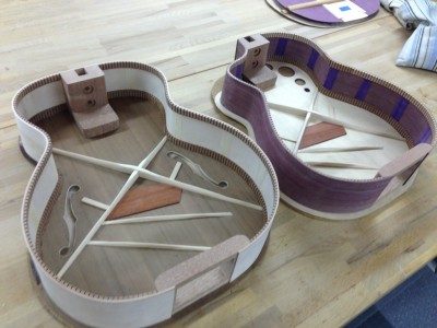

I haven't posted anything for a while so I thought I'd share a few photos of the two acoustics that I'm currently building. One is purpleheart and curly maple with a spruce top. The other is flame birch with a chocolate brown western red cedar top. Enjoy!

Why the open tail blocks?
Andy Bounsall
Posts: 120
Re: In the works
Post by Andy Bounsall »
John Clifford wrote:Why the open tail blocks?

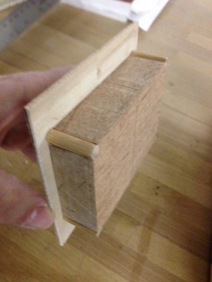

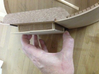

I'm trying something new (for me). Since these guys don't have traditional sound holes, there's no easy way to gain access to the inside to attach the bolt on neck, nor in the event that repairs, etc are ever needed. I made the tail blocks so that there's an access hole big enough to get a hand and forearm into. A matching piece of the side wood is attached to the cutout to form a trap door which, when completed, will blend in with the design and be almost invisible. Not shown in the photos below, but there I'll be a mechanism by which the removable trap door will be secured from the inside.

There'll be a short aluminum bar that spans across the inside of the access hole. An end pin jack, attached to the bar, will poke out through a hole in the trap door. Tightening the nut on the outside of the end pin jack will pull the bar outwards and the trap door inwards, locking the whole thing in place. At least that's the plan.
Clear as mud? I'll post some pics of the contraption once I have it all put together.
Posts: 1390
Re: In the works
I made an access plug that operated similarly to this. When you twisted the end pin it rotated the steel bar to verticle then pulled it all together to squeeze the plug in place. I like the dowel corners on your plug, did you do that because you drilled out the block then cut or for some other reason?
Andy Bounsall
Posts: 120
Re: In the works
I wanted a nice snug but not tight fit. Drilled the four corners (5/16" I think), cut between with a thin scroll saw, then glued the dowels into the drill holes. Worked out quite nicely.

That makes sense. I made mine by cutting up and re-laminating the tail block. It was similar to how you would make a bandsaw box.

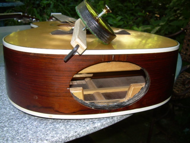

I made a tail port that was oval shaped and used a wooden "bar" to hold it in place. Just another way to do it. To fill the kerf that the coping saw blade made I moved the two cut off pieces of the sides outward before gluing them to the plywood backing - leaving a gap between them , which I later filled with an end graft. It allowed me to grain match the port to the remaining sides.

Would it make sense that the aluminum bar you mention, would be as wide as the "plug" itself when turned horizontal?
And then when turned vertical it would be long enough to hold the plug in?
All of that could be controlled with a couple of small dowels placed as stops on the inside of the plug?
Posts: 1390
Re: In the works
Gordon Bellerose wrote:Would it make sense that the aluminum bar you mention, would be as wide as the "plug" itself when turned horizontal?
That’s how mine worked, though it was a rectangle not an oval.
