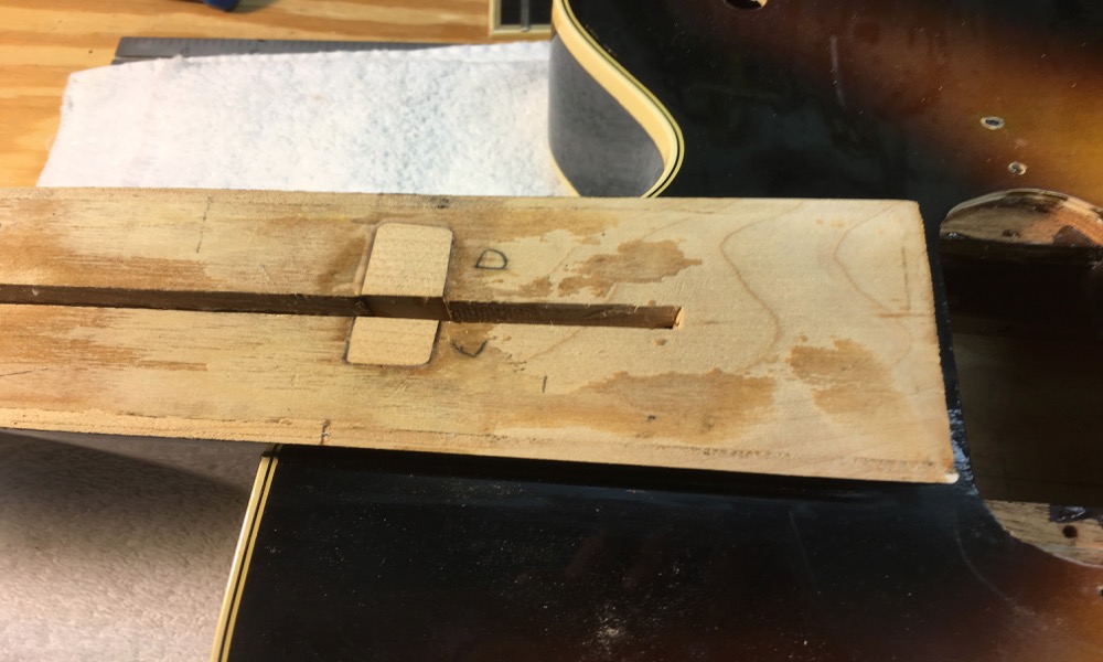

- Posts: 3254
Re: Burns Gear-O-Matic Truss Rod
I don't know if anyone is interested but here are some more photos of the Gretsch repair. I filled in the holes left from removal of the geared truss rod, including the 1/2" diameter access hole through the head block. I am currently building a new fretboard and will also be replacing the wiring harness and the pickups. The next step will be re-routing the truss rod slot because the new rod requires a 1/4" wide, flat bottomed slot whereas the old rod was in a 3/16" curved bottom slot.
