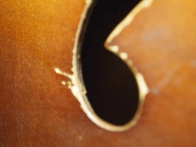

The Story so far:
As mentioned above, I found the battered old Hofner on eBay one day while on holiday and thought that she could serve well as a practice piece in order to hone some restoration skills. little did I know what i was letting myself in for!
initially i could tell from the advert that there was a pickup mounted in the soundboard and that the pick guard was not original. only 5 of the original machine heads remained and one of those had a new knob attached at some point in the guitar's history. The advert clearly showed that the neck and snapped clean off the heal.
Upon receiving the guitar and giving it the initial once over and stripping it down I discovered that there were many areas of concern from a back bowed neck, cut bass bars (as discussed at length above) as well as a crack at the bottom of one of the f-holes potentially from some kind of impact in the guitar's past. it was also evident that the bridge had been ruined and the metal threaded bars were protruding from under the feet of the bridge base and had been happily marking the top in that area through use and time. the bridge does not sit flush against the body of the guitar. There were also score marks in the surface of the soundboard from some questionable period in the guitars past where it might at some point have had a different bridge. either that or some kind of tape may have been attached under the bridge in a futile attempt to prevent further damage from the damaged bridge base.
