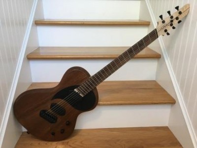

Hiya, folks. It's been a while since I've posted anything new. I've had a few guitars making gradual progress on the bench over the past year or so, but this new model - I call it the Alma - is an idea that came to me just a couple months ago and took over. It was mostly completed on April 29th, in time for the NW Handmade Musical Instrument Show at Marylhurst, but wasn't strung and set up until last weekend, for the Oregon Guitar Expo.
The shape is what you might call a non-cutaway off-set, and I decided to try my first Fender-ish stepped-down headstock. Actually, the shape is something that I've been playing with for ten years or so, which has been scaled from a uke to 3/4 size and even OM-ish outlines. I used the template for the 3/4 size guitar, and it's petite: 17-1/2" length, 13" lower bout, 7-1/2" waist, 9-1/2" upper bout. This prototype is super thin, at only 1-1/8".

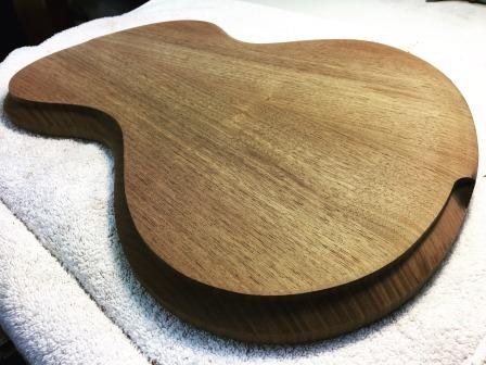

The wood for the body was a long piece of walnut scrap that I got at a salvage yard. It was probably 4 feet long, 8 inches at the widest, and almost 3 inches thick. With some clever slip-matching and book-matching I was able to make a 4-piece blank.
It got a deep, stepped bevel on the bass side.

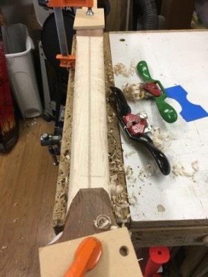

The neck is maple/alder/maple, and I started with a blank 3/4" thick. The back of the headstock and heel were given a veneer to bring those areas up to 1" so that the headstock step could be deep enough and the heel could be tall enough. There are 1/8" x 3/8" carbon rods alongside a double-acting truss rod with a spoke wheel at the heel.

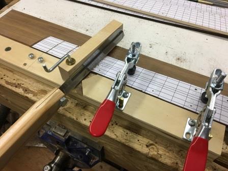

The fingerboard is walnut, and I left it a little bit thick at 5/16" to add some stiffness. Fret slots were cut in my adjustable fret slotting jig. Frets are Jescar jumbo stainless.

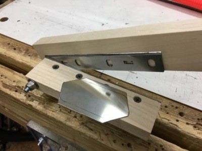

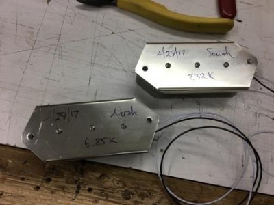

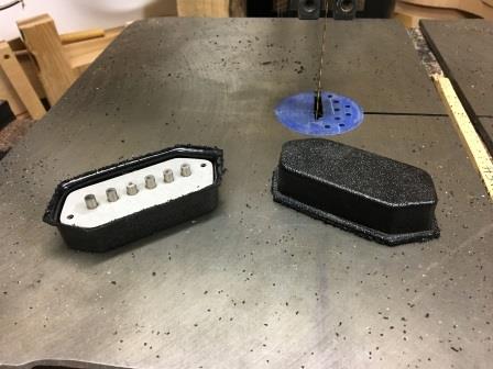

A while back, David King gave me a handful of A2 rod magnets, and so I've been thinking about what kind of pickup I wanted to try making with them. My pickup rout shape looks a little like a tilted, dog-ear P-90, so I decided to try out something like that. Flatwork is made of 1/16" fiber sheet, and the bobbins are a little taller than a true P-90 at 3/8". The baseplate is nickel silver sheet, cut with a guillotine that I made from old jointer blades. Once again, I thermoformed some covers from black ABS with the textured side out.
The last pickups I wound were super hot, so I decided to try something a little more "vintage," and went with 10,000 turns of 42awg on the bridge and 9250 on the neck. They came out in the upper 6k and lower 7k range.
The wire turns is the only thing that they have in common with real P-90s, though, but they sound good.

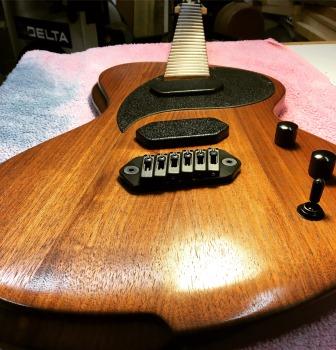

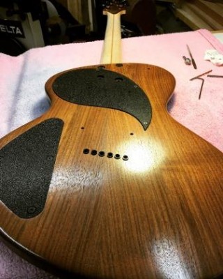

I'm really happy with how this came out. It's light, balances well, plays great, sounds cool, and looks amazing (if I do say so myself). Finish is tung oil over shellac. More of the ABS was used for the pick guard and "belt buckle guard." I have it wired with a simple 3-way, volume, and tone.

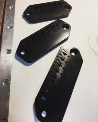

One more thing: check out the bridge plate. This is a design that I've been working on with John Sonksen (forum participant and local Portland friend). I drew them up (poorly) in Fusion 360, he refined and CAM-ed it all up, then went into work on the weekend and milled them in aircraft aluminum (he's a CNC programmer and operator). Anodizing was done at ElectroChem in SE Portland. These are frickin' gorgeous! They use GraphTech Wilkinson style bridges and come in 6-, 7-, and 8-string versions. SOOOOO appreciative of John's work on these components. They're making my designs possible and really moving my work forward.

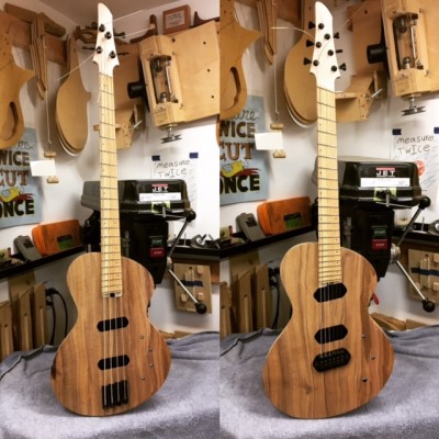

Thanks, Matthew! The koa twins, as I'm calling them, are coming along nicely. (Actually in finishing now. This was basic stringup.)
I've also added a cutaway option, and I may be starting another guitar and bass twins project soon.
