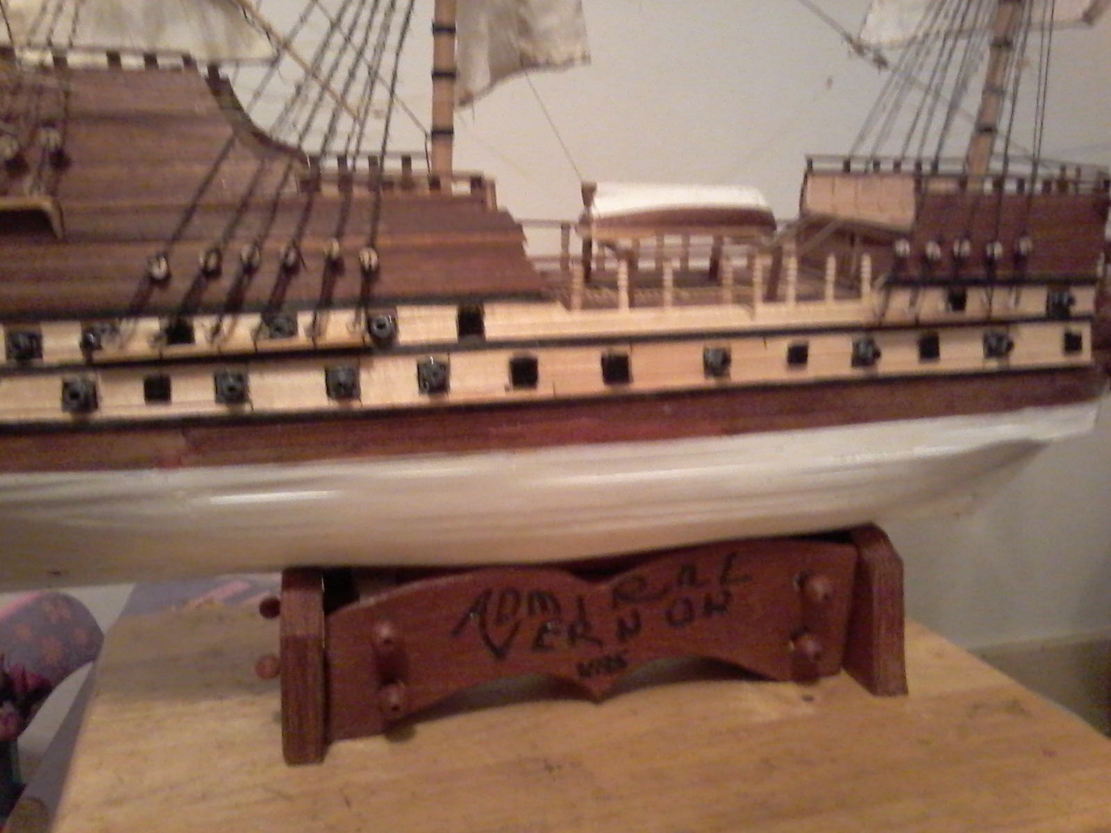

Yeah !I used magnets to hold the wooden spheres on the base unit of my Admiral Vernon.

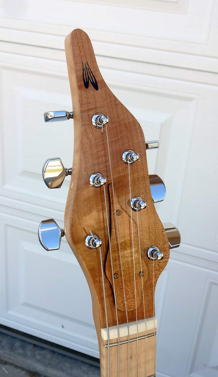

That is an interesting head stock design .Flame motif perhaps ?
Posts: 1322
Re: I decided to make a new truss rod cover. ..
Yes, it does look like a flame. Actually, in designing it I wanted the headstock to loosely echo the shape of the body.

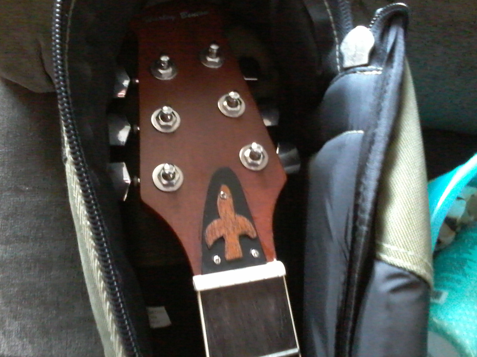

Here is a LP clone, ice tea 'burst over maple, rosewood f/b and headplate
Tried black plastic, didn't like it
Made one out of some flamed maple with a little 'burst, just not right
Finally just glued some fiber backing to rosewood veneer and put a couple of coats of lacquer on it
Here's another Lester, Spanish cedar top and headplate with rosewood f/b, binding, pickup rings, knobs.
Rosewood t/r cover seems to go with the headstock binding
If you laminate some white or black fiber to the back of the veneer it keeps it from splitting and gives a fine line that can tie into other purfling themes. Here is ebony on ebony
And a long story behind this one - the owner is one of the finest custom motorcycle painters in the world - he requested skulls for his f/b inlays. I added one to the pick guard
and another in the ebony t/r cover

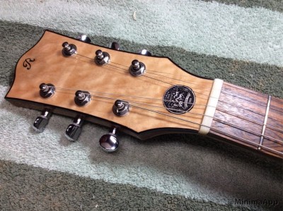

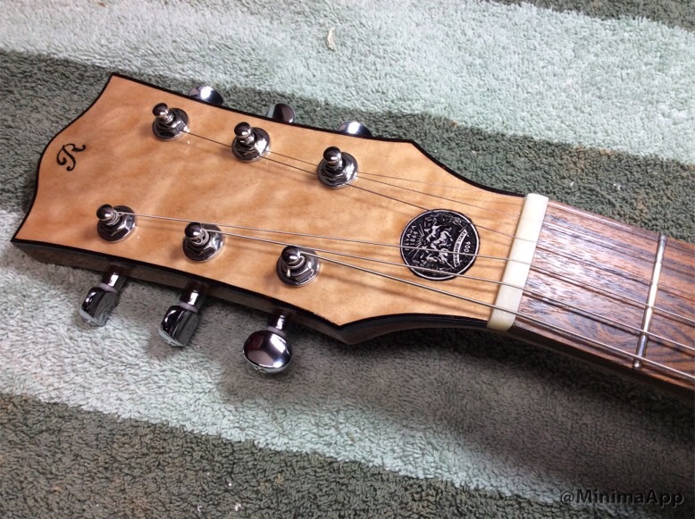

Phillip Rowe wrote:Interesting use of a coin as a truss rod cover.Magnets ?
Two black screws.
I rarely have cash, and found this coin in my pocket. Not sure how it got there, but aimlike the horses.
I painted it black, polished it, and applied a clear coat.
