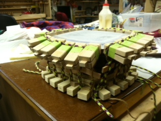

Hide glue or Titebond will work. The skin needs to be wet so it will stretch, as has been said. You will also need a way to tension the head while it dries. I repaired a Shamisen sometime ago using a goatskin. Shop-made clamps and twisted ropes for tension. Perhaps this photo will help.
