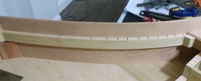

Re: Building a bentside spinet

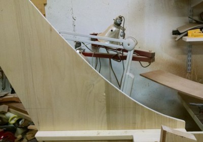

Finally some progress. I tweaked the bending jig a little and soaked the tightest radius of the bend in some "SuperSoft" for a day or so. The soaking seemed to do the most good. My heat pipe isn't quite big enough to do much. Short of laminating, I may try a steam box next time.
The bent side: I traced the actual bend onto the base board and then cut. In retrospect, it probably would have been better to do this before the rest of the assembly... Fitting the side to the baseboard. Still have a few miters to cut.

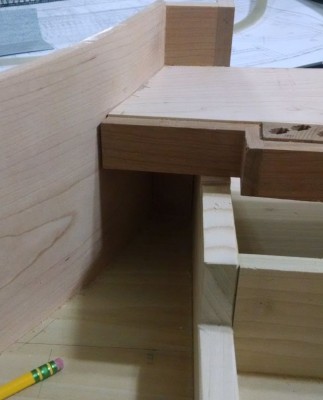

I added three corner reinforcements. The first couple were easy. The third one (the dark hole) was tough. Note to self- next time, fit this before gluing on the side.

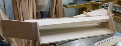

Then I started on the keyboard. First up is the basic frame which is just two sides, the back member and balance rail (the keys will pivot on the balance rail). The keyboard assembly can be slid in and out of the instrument.Here it is by itself: And in place in the instrument:

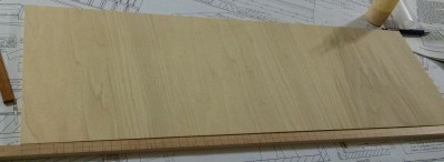

Building the keyboard is a 7 step process. Here's the prep and step 1.
First is getting the blank to shape. It's about 800 mm wide, 12 mm thick. The treble side is about 260 mm deep and the bass side about 300 mm deep. I'm using poplar. Next is the keyboard ruler that marks the edges of the natural and sharp keys. Barnes drew this on the plan, and I copied that to a stick. Here we extend the lines for the natural key edges from the ruler onto the keyboard blank using a square. Completed. The tic marks at the top of the line indicate where the sharps will be. Next is to glue on the tops of the natural keys. The original Keene & Brackley used ebony for the naturals and ivory for the sharps. I've probably got enough ebony (in fretboard blanks) to do ebony naturals and then maybe use maple for the sharps. But I'm also thinking of maybe cherry naturals and maple sharps. Could also go with maple naturals and cherry sharps too...

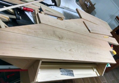

I also started the lid and flap. Here I'm just getting some boards in place prior to glue up.
http://www.traditional-brassware.co.uk/ ... 1/spinets/ (in my case, references 13 - 16).
The lid is attached to the case (in the back) with three hinges. The flap (which covers the keyboard) is attached to the lid with three more hinges, and there is also a lock on the flap. The hinges are drawn full-size on the plan and they are really cool. I wasn't particularly looking for exact replacements, but I learned there is a guy over in the UK who actually makes replicas of these (and many others). As you can imagine, they are not cheap- I'm guessing US $350 (plus shipping) for the set. You can check them out here: -

Charlie, re: your kerfed bentside liner, how can you be sure that your hitch pins won't be driven into a kerf rather than the solid part of the liner, thus being subject to pulling out from the tension of the strings?

Bill, I wondered that too. The kerfs were marked on the plan, so hopefully they are strategically located.

Got the top glued up and rough cut.

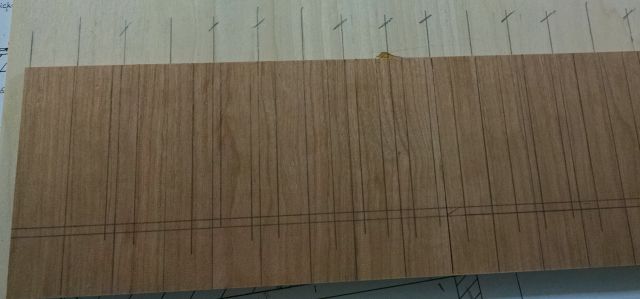

Back to the keyboard- I'll use cherry for the naturals. I cut the pieces 4.5 mm thick and then cut the width so that the edges line up between keys.
Here they are glued on, with the lines redrawn. I used HHG here because some of the cherry will have to be removed and replaced with the sharps The sharps are also drawn on, and a couple horizontal lines that define the front of the sharps and the where the chamfers between the naturals end. The horizontal lines will be "boldly" cut as they are also decorative.
Another shot of all the lines- the two horizontal lines above the key tops mark where the balance pins will be drilled for. The sloping line is just to keep the keys in order after they're cut out. The top line is the end of the keys. As I type this, I remember that I need another line at the top to mark the depth of the slots that get cut in the end of the keys. I also should taper the key tops front to back (and redraw all those lines again...).

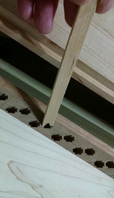

The recommended way of figuring out where to cut the keys apart is to locate where the jacks will go. So we make a dummy jack with two points on one end.
The keyboard is placed in position and the jack drops in the slot. You can see the jack resting on the end of the keyboard.
Then we take a mallet and rap the top of the jack to make a pair of marks on the keyboard blank. Repeat 55 times.
And here you can see the dents left in the keyboard.

Getting there- I extended lines from the key edges to the back of the panel. Each line was drawn so that it falls between the pairs of marks left by the dummy jacks.

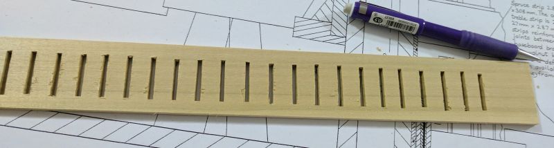

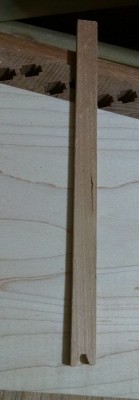

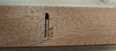

Next is the rack- this sits (vertically) behind the keys and acts as the guide for the keys, keeping them moving straight up and down. Here, I've transferred the center of each key to the rack, and extended the lines.
Now the idea is to cut slots (1.7mm wide) in the rack, centered on the previously drawn center lines, for each of the 56 keys. There's probably a number of ways to do this, but I followed the Barnes book here. Build a little jig with two fingers spaced about 1.9mm apart (you can guess I used an old hacksaw blade here). Center the line drawn on the rack between the two fingers and use a knife to score a pair of lines. Then use a chisel to chop out the slot. Well crud, perhaps I should have been a bit pickier about the wood I used for the rack. I can probably glue this crack, but I've got 55 more slots to do. Barnes recommends a chisel with a 12 degree edge.
Anyway, here you can see the scored lines and where I chiseled out one of the slots. To minimize friction between the key and the slot, we want just the front edge to be the guide, so we need to chisel at an angle (i.e., the slot will be wider at the back of the rack than the front. The slot in the back. Need to use a harder backing board too methinks.
Ok, take 2. Redone with poplar, much better.
Front: Back:
Front: Back:
