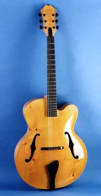

I'm a total newbie and can't call myself a maker yet. I got the Benedetto book on archtops and in it there's this one picture of a guitar he made that made me smile. The top is made from a 2x10 piece of pine from a lumberyard. He says it sounds great. One of the things I'm learning from you guys is building a great instrument is more about how many you make, not the materials. This is quite liberating. Just start building and when you're done do another. Start with nice wood but don't worry about the quality. Just do your best and learn. Repeat.

The picture below is of the Benedetto guitar Mr. Knapp mentioned.
I have sets of insanely super quilted Sapele, which is flat-sawn, which for years I hesitated to use because it's tap-tone is like cardboard. When I finally used a set the guitar's tone was wonderful. it sold very quickly.
Putting a lot of concentration and experimentation into the guitar's soundboard has served me well.
