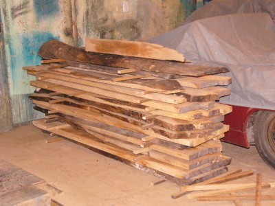

Posts: 922
Re: Got a log yesterday... update with picture...
Post by Brian Evans »
Got my log sawn, and picked it up today. Interesting to say the least. the portion of truck I had was split midway into two smaller trunks, so we got some interesting pieces. It had lain down for a while, so is quite dry and has some end splitting and spalting, so some sections are quite pretty. I planed off one section, and it has definite curl to it. Some boards are 18" to 20" wide in sections, and it was sawn to 1.5". Very fun!
Right on! What wood are you using to sticker the stack? Are those cutoffs of the log itself? Some woods don't play well together, and you can get staining. Also, if airflow isn't good, you can get mold under the stickers, which can also cause discoloration. If the wood is already fairly dry, you should be ok. The best solution I've seen for inexpensive, nonreactive stickers is small diameter PVC pipe rippled down the middle.
