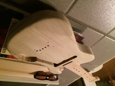

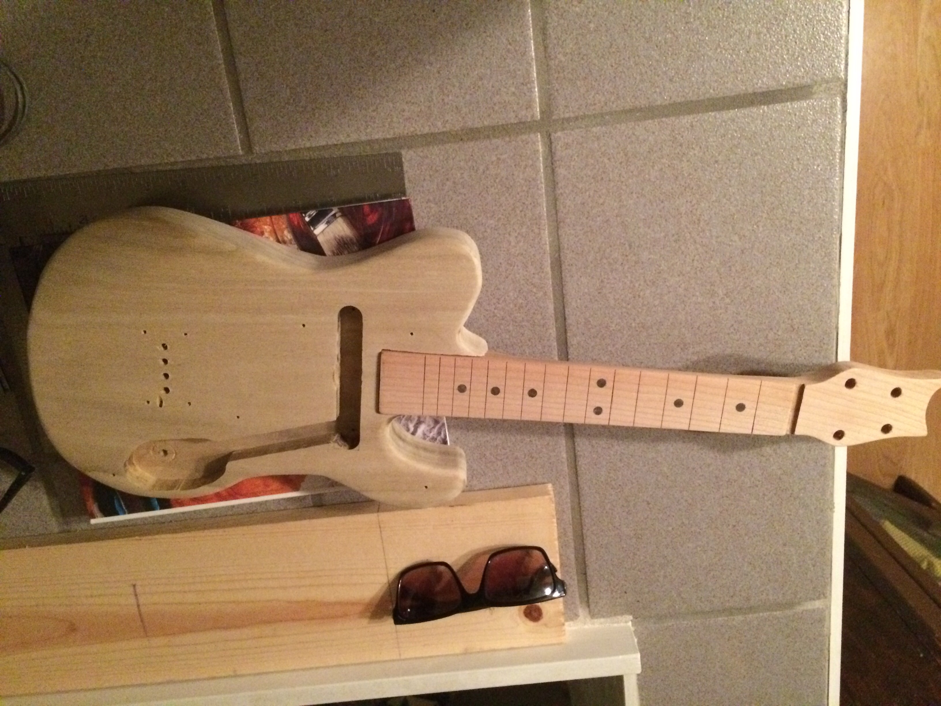

Here are a couple pictures pre-finish.

I'd start with .010" guitar strings and see what happens. Your idea of a guitar capo'd at the the fifth fret is about right. Tension will be about the same, response to bending will be different since your string length is a lot less. The strings will feel a bit stiffer.

16.25" scale is closer to capo'd at the 8th fret, string length wise, but you are down-tuning three half steps to get to the low G uke tuning (which is of course the same as guitar capo'd at fifth fret). You will lose a lot of tension with that, around 40% off the top of my head. Some depends on what you plan to play on the instrument. If just strumming, I might buy a set of .009's or .010" guitar strings and use 5 through 2. That would give you a wound G and C. If playing single string you might try a set of .011's and use four through one, that would give you an unwound C.
What is your thought process for placing the fingerboard dot's, btw? And not fretting the neck all the way to the end?

I ended up buying a set of .010's and using strings 1-4, and it seems to be working out fairly well. I didn't think of using 2-5 though, and I might try that whenever I change the strings. As far as the fingerboard markers, I've been looking at this project more like a tiny guitar than a ukulele, and since I am already familiar with the guitar fingerboard I decided that having this correspond would make it easier to find the notes rather than worry about transposing in my head. So I suppose the short answer is that I wanted to be lazy. :) I didn't feet to the end of the board simply because I didn't have enough fret wire on hand.
