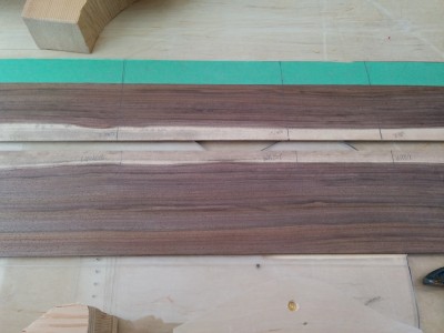

Good morning, folks!
This is my first post to MIMF, and unfortunately I come with a question!
I'm building my first guitar from scratch right now - a 000 with a cedar top, walnut back and sides.
I have the top joined and braced, so now I'm working on the side preparation. The sides are currently 4-5 mm thick, and I'm hand planing them down to 2mm. I've discovered a crack in one of the sides that runs for about 15cm along the grain, near the top of the side. The crack line shows on both sides of the board, and I can move it a little when pressing on it.
At this point, I think I only have a few options, and I would really like some feedback/advice moving forward:
Option 1: Scrap this side set and start with a new one.
I would prefer not to do this because the set matches my back.
Option 2: Stabilize the crack, and continue.
I "think" this is possible, but I'm not sure how. Would it make sense to flood the crack with CA glue, etc.? Before planing or after? Comments, anyone?
Option 3: Trim the sides down to the crack.
I can do this, but it doesn't leave me with any "wriggle" room when I'm at the point of profiling the depth of the guitar. Thoughts?
I would really appreciate any suggestions or advice I can get at this point. Thanks..

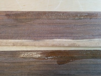

I thought I would give my "unofficial" mentors a look at what I've done with the crack so far.
As per advice, I mixed up a batch of HHG, and I basically slathered it on the crack area on each side. I didn't worry about being neat, since I knew I'd be planing it off. The crack is actually quite visible. Then I started planing. I'm working it down to 2mm , as per the instructions in the book I'm following. Alex Willis's book.
The crack is definitely still there
, but I'm down to thickness and nothing has disintegrated yet, which must be a good sign!
I checked the height of the side once it's joined to the top and bottom, and the crack will be almost totally eliminated, so I'm very tempted to cut to the profile now. Is that a good idea?
I also thought of flooding the crack again with a really thin application of HHG, before bending. Any thoughts?

- Posts: 3253
Re: Question re: crack along the grain of a side board
You should have used clamps and closed that up. A glue filled gap has no strength and will always be ugly. But even if your crack falls onto the side, it will probably be removed when cutting your binding ledge. So plan and layout the parts accordingly.

I thought I would post to let my mentors know that I've made progress with my cracked sides.
I did everything as suggested, using hot hide glue along the seam of the cracks, then compressing the area with clamps. After it dried and settled, I started planing the sides down to 2mm (ish). I did a lot of planing the old-fashioned way, using a #4 Stanley, and the cracks were very stable except for one little spot. Since I got a little worn-out from that and everything looked fine, I ran the sides through my my drill press safetyplaner attachment, and got them down to 2+mm.
Then I scraped them until I got to final thickness. Everything looked good to go!
Todd Stock recommended taping the cracks when bending, and that is what I decided to do. Here's a picture of the sides with layout and tape on one.
So...now I've bent 1 - count them - 1 side so far. My bending iron decided to be fussy today, and the construction site next door brought all our power down for 2 hours! Either way, 1 bend today...another tomorrow! When you're retired, there's no rush!
Here's my first bent side in the form cooling off.
Thanks again, folks. I'll post a true build record in a day or so.
