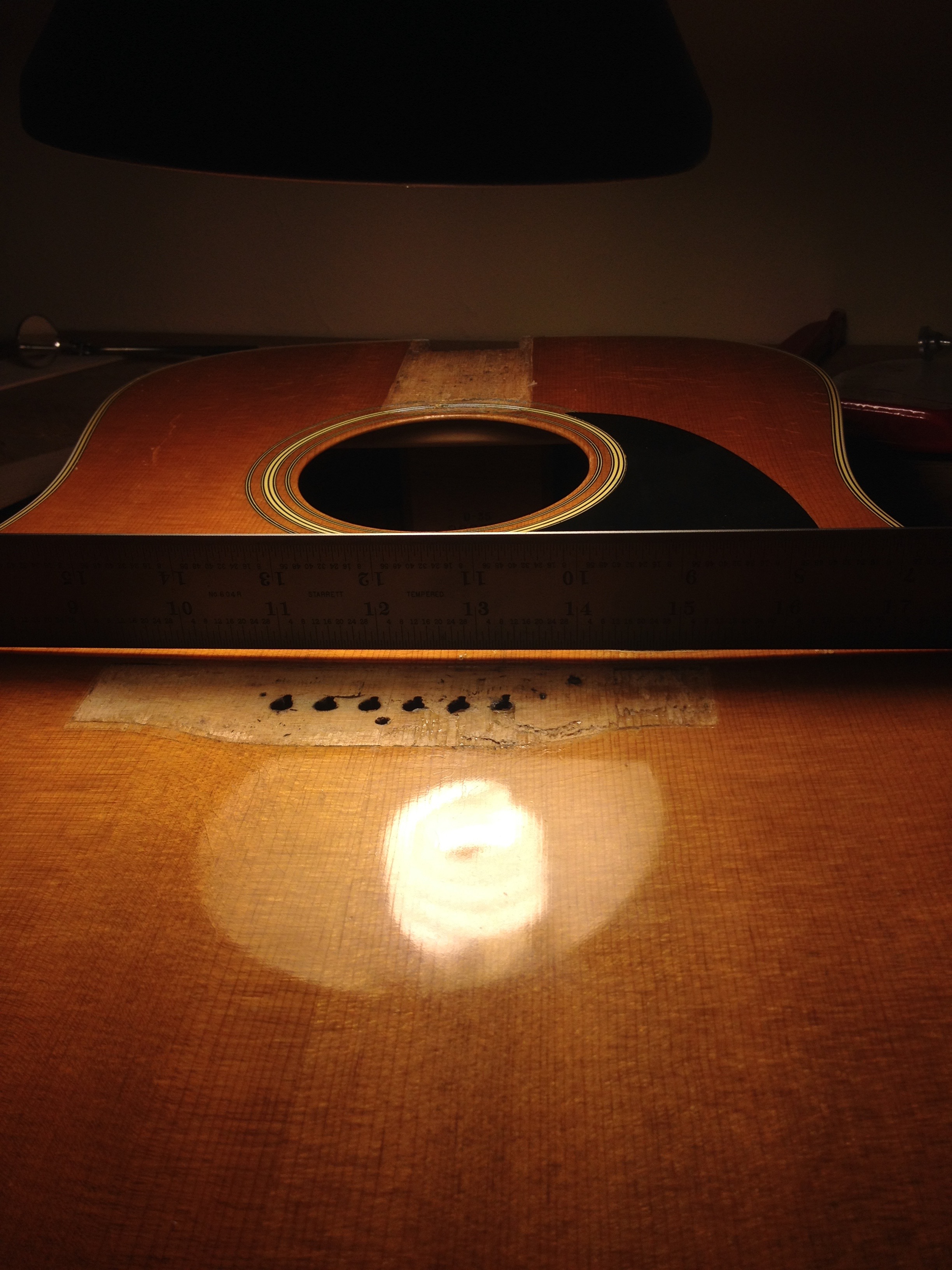

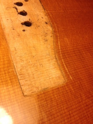

Postby Matt Atkinson » Sun Mar 13, 2016 5:31 pm
Thanks for all the good advice. I have removed the bridge. The old bridge was set into the finish as expected but it also looks as if the top was compressed by the bridge in some way (?). The step between the raw wood beneath the bridge and the adjacent finished area is almost 1/32" behind the 5th and 6th strings. Less elsewhere.
The top is fairly uneven due to wear and repair and age. I have to move the bridge back 3/16" on the bass end and 3/32" on the treble (it was badly positioned) and will scrape away finish behind it. I am accustomed to shaping a bridge by laying sandpaper on the top and sanding it to fit but this top is irregular and I am looking for suggestions on how to fit it. I'm guessing it's just s slow sand, test and fit process. Advice appreciated, thanks.

Postby Matt Atkinson » Sun Mar 13, 2016 6:02 pm
Looking into this further I have an idea and need you folks to tell me if I'm nuts. Perhaps I could glue a piece of spruce the shape of the old bridge in it's footprint, level it and glue the bridge over that? Crazy?

Postby Matt Atkinson » Sun Mar 13, 2016 6:22 pm
More issues. Hopeless?

Postby Michael Lewis » Sat Mar 19, 2016 2:59 am
Leave the bottom of the new bridge flat and it will help keep the top flat. If you make it fit the 'contours' of the top they will become a permanent fixture.
Possibly someone has 'cleaned out' the area under the bridge by removing some of the spruce. Tsk tsk! Clean the surface of any glue or finish where the new bridge will cover and glue the bridge with lots of clamping force. I use two spool clamps I made in the outside holes and three regular bridge clamps, one in the center and one on each wing. Use clamping cauls to prevent any marks from the clamps, and reef that sucker down good. My general preference is hot hide glue but good aliphatic resin glue (Titebond, etc.) should suffice. Don't disturb the clamps for 24 hours.
