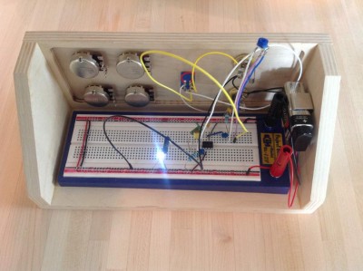

Before starting the PCB layout, I wanted to make sure the circuit works and sounds decent. Here's a photo of the circuit prototype on a breadboard. It worked and sounded pretty good to me.
To simplify connecting the guitar into the circuit I made a simple panel that houses input/output jacks, a switch to put the circuit inline or bypass and some commonly used potentiometers.

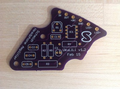

Again, I used Eagle Light to lay out the PCB. My initial plan was to cut a foam insert for the electronics cavity and let the circuit sit in a cutout in the foam. Because I chose this "mounting" scheme, I did not include any mounting features on the board. Here's the board layout. Its a two layer board with the red traces on the top and the blue traces on the bottom. The gray lines show the silkscreen and the green circles are the solder pads.
I had the board fabricated by OshPark. I've been really happy with their quality, prices, minimum quantities and turn around time. Here's the board as received from fabrication and after being populated with the components.
To give a sense of scale, the board dimensions are 1.25" x 1.35".

So after giving it some more thought, I decided that the foam insert in the electronics cavity wasn't going to be a great way to hold the circuit and battery in place. I looked at some other mounting options and concluded that the circuit could be held on some standoffs that double as the nuts on the switch screws. The only drawback to this mounting scheme was I needed to have a new PCB made that had a shape to fit into the electronics cavity at the switch location and also included mounting holes with the same spacing as the switch mounting holes. Here's the layout from Eagle Light and the PCB as received from fabrication. I also took the opportunity to learn how to make curved surfaces and add graphics in Eagle Light.
Here's a photo of the populated PCB including the entire wiring harness. I used locking connectors for connections that may be need to be removed occasionally (pickup, battery, output jack). The wiring diagram is shown in the subsequent image.

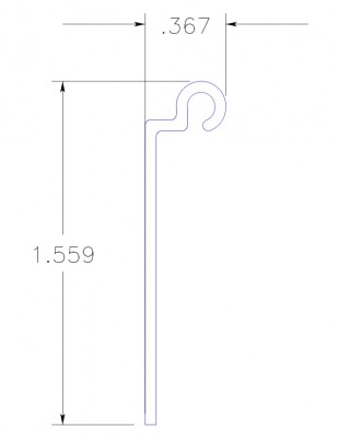

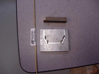

My plan for the UkuLiLi is to use a bone saddle acoustic bridge with a trapeze style tailpiece. Since this project is also an excuse for me to learn more about CNC programming, EDM and milling I made my best attempt at fabricating all the necessary tooling to make the parts I need. Let's start with the tailpiece...
The tailpiece consists of three parts: the string retainer/anchor, the wire and jack/end plate. All parts are made of brass. To make the wire, I machined a plate with holes for 1/8" pins at the bend locations and a groove to indicate the final contour.
I used C-clamps to hold the wire in place during bending.
After bending, the wire was trimmed to length with a cut-off wheel.
I was pretty pleased with the way the wire turned out. It is flat and looks pretty symmetric to my eye.

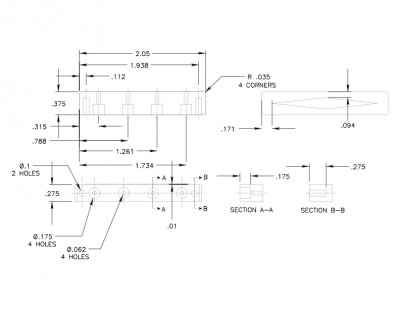

Next up is the string retainer/anchor. Here's the drawing for the part.
And here's a (poor quality) photo of the finished part. No in process photos; the part was made entirely on the mill.

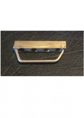

To complete the trapeze portion of the tailpiece the wire needs to be attached to the anchor. I made this bond by brazing the two parts together in my oven (I did this when my wife wasn't home).
The braze material/solder I used had a melting temperature of 430 F. My oven goes up to 550 F, at least on the display, so there was no trouble heating the parts above the melting temperature of the solder. I assembled the parts, squirted a little of the included flux in the holes with the wire, put the assembly on a baking sheet and heated to 500 F. When the oven reached temperature I let the parts soak for about 30 minutes. Next I pulled the baking sheet out of the oven and touched the solder to the wire on each side. Thanks to the flux, the solder melted and flowed down into the hole. I tried to limit the amount of solder so I didn't have a lot of overflow. Once the solder was in place I put the parts back in the oven and let them soak for another 30 minutes before removing to cool.
Here's a photo of the final part after the braze, seems plenty strong! The stains from the flux cleaned up easily with some 0000 steel wool. The part looks a little skewed in the photo but that's an illusion due to camera angle.

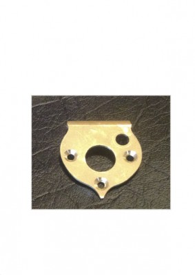

And finally on to the jack/end plate. The plate needs to wrap over the end of the UkuLili and provide a means of holding the wire on the trapeze. Here's a drawing of the side profile. The open loop allows me to slip the trapeze in and out as necessary.
To make the part I started with a piece of 0.5" x 3" brass. I cut the side profile on the wire EDM so when finished I had this profile with a width of 3". Next I moved to the mill to drill the holes and cut the outer profile. Here's a photo of the finished part; the second small hole is for the LED.

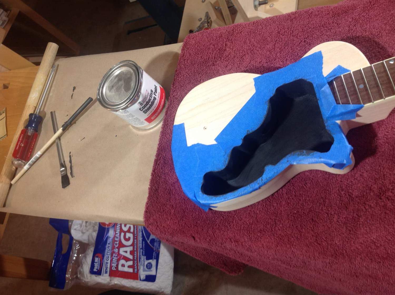

On to finishing! Since this is the first guitar that I'll be finishing (I've sent the previous instruments I made away to a pro), I elected to use spray cans of nitrocellulose lacquer from ReRanch. The color I chose is Copper Tone Metallic. Before applying any lacquer, I painted the control cavity with conductive paint.
In hindsight, painting the control cavity with the conductive paint prior to applying the lacquer was probably a mistake. I did a little touch up sanding and proceeded to grind the shielding paint particles into the wood. I'm hoping it won't be an issue with the final result since it will be buried under many layers of lacquer.
Here's a photo of how I'm holding the guitar for finishing. To spray, I made an internal frame for a chest freezer box I had on hand.
