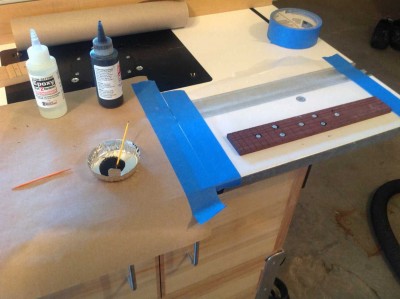

I started out by making the fingerboard. First I jointed one face and one edge and used the drum sander to reduce the thickness to a little over 0.25". I use a cross-cut sled on my table saw along with the StewMac blade to cut the fret slots.

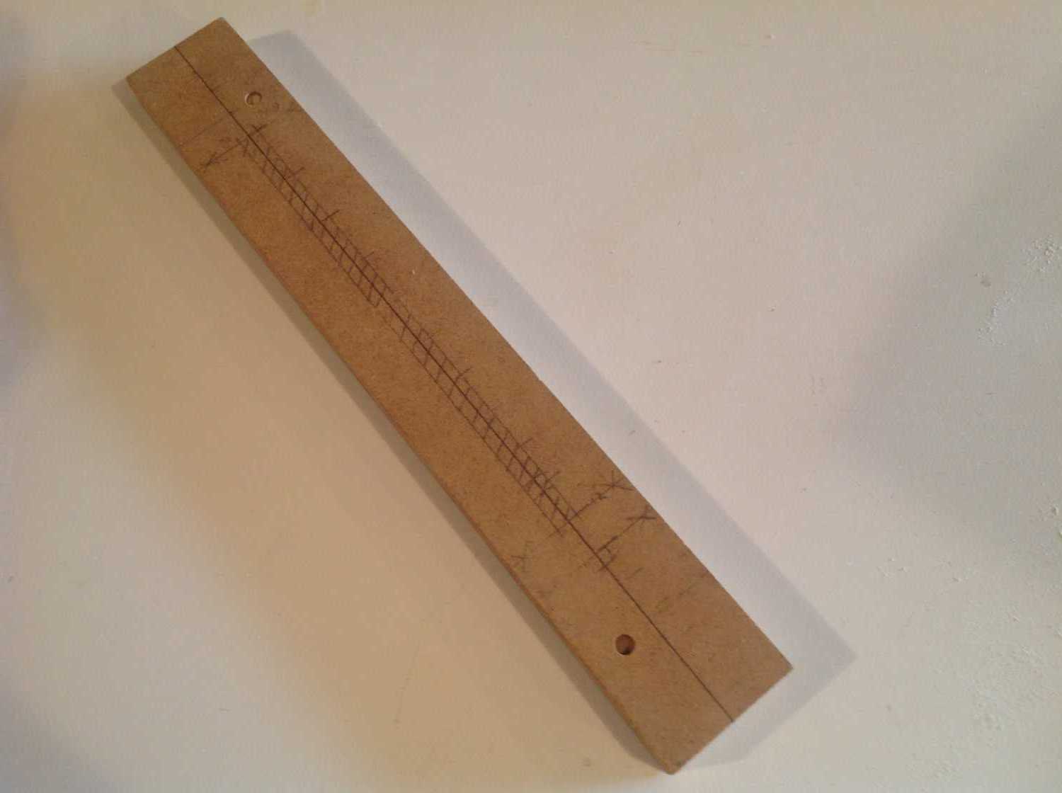

I have access to an EDM and CAM software and thought this might be a good project to learn how to use them. I decided to make my own fret scale template. If you look closely you'll see that I'm not a great machinist, but the template worked well.

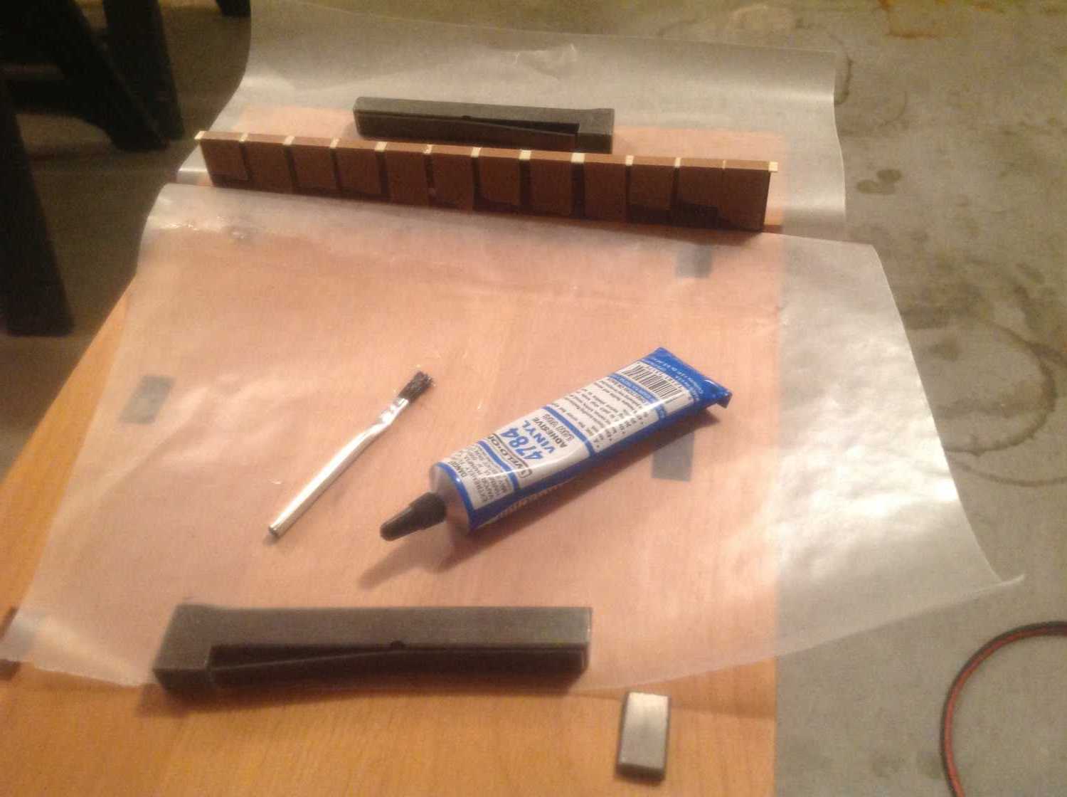

After cleaning out the fret slots and cutting them to final depth, it was time to install the binding. This the first fingerboard binding job that I've done and I had a really hard time getting a good bond between the 0.040" think ivoroid binding and the wood. In fact, this is where I messed up the first fingerboard. I started off with the Weld-On #16 (I think this is what StewMac recommends) and the binding easily popped off while I was scraping it flush. I scraped the glue off the wood and tried again with the same results. At this point I set up an experiment using Weld-On #16, Duco cement, StewMac epoxy, StewMac medium CA and acetone/wood glue. From these tests, it seemed that CA worked the best. However, the binding detached from the fingerboard again while scraping. At this point the fret slots and fingerboard surfaces were gunked up with CA and I didn't have any more scrap to test on so I decided to dedicate this fingerboard to further testing and start fresh with a new fingerboard.
This is getting to be a long tale so I'll just say that eventually I happened upon the LMI site that recommended Weld-On #4784 and that gave me a good bond. I scraped the binding and finished sanding the radius.

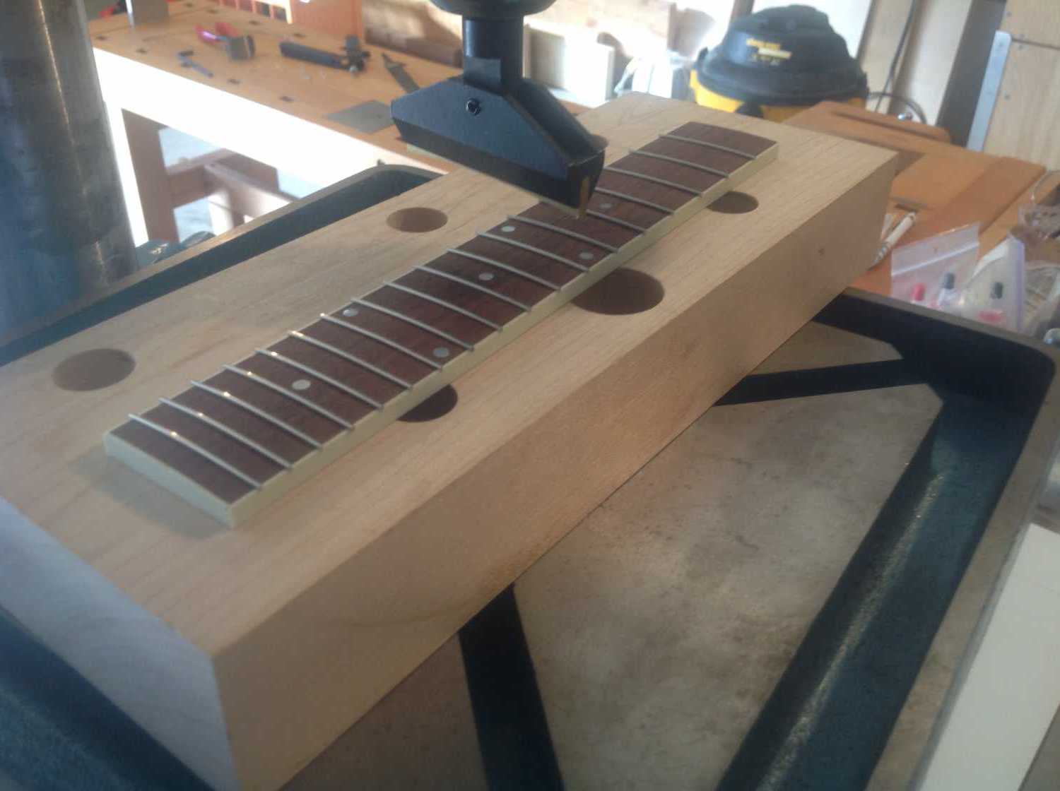

Lastly, fret wire was bent to approximate radius, cut to length, ends were nipped and frets were pressed into place. I used StewMac Narrow/Medium fret wire for this. Fret ends were beveled at 45 degrees.

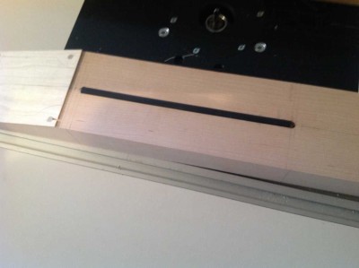

After the headstock was glued, I used the router table to cut the slot for the carbon fiber rod. In hindsight I should have done this prior to glueing the headstock veneer. Because I didn't, I needed to prop the neck blank up on some small blocks to clear the headstock veneer.
The carbon fiber rod is from LMI and measures in at slightly greater than 0.25" in diameter. Rather than trying to cut my slot slightly wider than the 0.25" diameter router bit, I chose to chuck the rod into my drill press and using some sand paper, bring the diameter down until it was less than 0.25" and fit in the slot. The rod sits slightly proud of the neck surface so that it mates properly with the fingerboard recess.

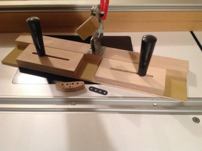

Still working on the neck... Next I cut out the headstock shape. I made the template on a CNC mill that I'm also trying to learn how to use effectively. I taped the template in place and drilled the 1/4" holes for the tuning machines. I like to drill the tuner holes before thicknessing the headstock to avoid any tearout. I put 1/4" dowels in a couple of the tuner holes to keep the template from slipping. I also used my sanding ramp with a board screwed to the angled portion so that my headstock face is perpendicular to my drill axis.
Instead of using the router table for this, I decided to try a technique that was posted on the LMI site as one of their informational videos. In a nutshell, I made a cutter by grinding an angle into the non-drill end of a 4mm drill bit. The shank of the bit rides against the template. I ran the drill at about 2000 RPM for this operation. Advantages of this method are that it seems really unlikely that you will get tear-out and you can also get into smaller corners than with a commonly available pattern router bit. Disadvantages of this method are that the chips don't clear so you need to clear them after each pass and sometimes within a pass to avoid burning and this method also takes longer than a router since you can't take very deep depth cuts (I took about 0.1" off in each pass). Overall, I thought the advantages outweigh the disadvantages for me.
To finish the headstock, I used the bandsaw to cut away the excess and then used the sanding ramp with the router to thickness the headstock. I don't have a photo of this last operation but, in a nutshell, the neck blank can be oriented in the sanding ramp so that the angle of the ramp aligns with the required angle on the back of the headstock. I then used the router from my router table with the plate attached (see next photo as an example) to mill the headstock down to final thickness.

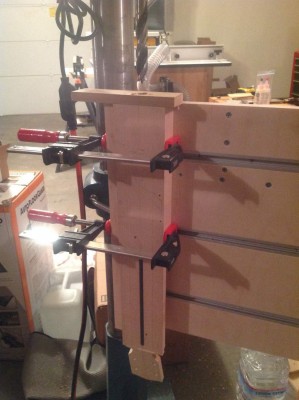

Back to work... After cutting the neck thickness taper I chose to drill the jack plug hole while the neck blank still has square sides. I used a 5/8" drill bit, a vertical drilling jig and a drill template for this operation. I need to drill deep enough to penetrate into where the electronics cavity will be; you can see the outline in the photo.
I made the drill template so that I could get all of the tailpiece holes, the jack plug hole and an LED access hole all lined up. I will be using a Fishman Switchjack End Pin Jack to save space in the electronics cavity, though I won't be taking advantage of the switching capability.
You can also see in the photo the two holes that will be used to align and position the neck width taper jig and the fingerboard.

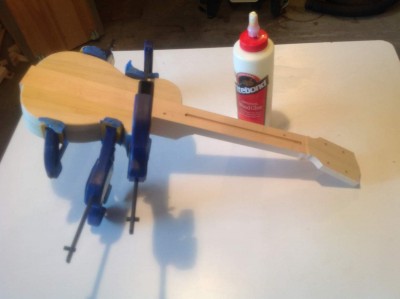

With the body wings prepared, the next step was to glue them to the neck. I did one side at a time. The photo shows the 1/4" diameter holes used for alignment. There are corresponding holes in the neck blank that are not visible.
And side two. Starting to look like a guitar - er, Ukulele - now!

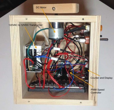

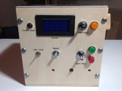

Since this was my first home made pickup, and I don't anticipate making a lot of my own pickups, I opted to make a pickup winder rather than purchase one of the commercially available winders. The winder was cobbled together with parts from Mouser, Amazon and McMaster-Carr. It's a pretty standard design; the internals are shown in the following photo.
The winder is powered by a 12VDC signal. The speed can be controlled with a potentiometer connected to the PWM controller. The polarity of the DC can reversed so the bobbin can be spun clockwise or counterclockwise. The LED display/counter uses a Reed switch to detect number of rotations. The motor spins at a maximum 500 RPM.
Next is a photo of the bobbin mount and Reed switch magnets. The screw at the top is for attaching to the motor shaft. The two holes at the bottom of the mount provide clearance for the bobbin brass eyelets. Double stick tape is used to attach the bobbin to the mount.
I like bright, shiny lights so I added a lot of them. The wire guide is removable for more compact storage.
Lastly, here's a photo of the overall assembly with a bobbin mounted and the wire guide in place. To control wire tension I used a piece of felt sandwiched in a C-clamp with the wire running through the felt. With this configuration it took about 20 minutes to wind the pickup; I need to switch out the motor for something faster now that I know what to expect.
Final specifications on the pickup: enamel coated wire 43 AWG, 7500 turns, resistance of 5.22 k-ohms, wound CCW when viewed from the top.
