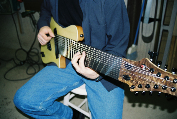

Here's a crazy fan fret project.
Built an 11 string electric about 10 years ago, according to the customer's blueprints, and the main problem was the bass side needed a lot more compensation than he originally calculated.
You have to build, at least I did, a special adjustable miter sled to cut the frets on the table saw. There is only one 90 degree fret and the rest are all on different angels.
Granted this is a way out there guitar but if I ever built another I would find a way to check intonation before placing the bridge.
Joel
Joel

Joel, I figured I would have to hand cut the fret board using some kind of jig, but I would love to know what you built for the table saw. I cut my regular fret boards that way.
- Posts: 66
- Joined: Sun Jan 08, 2012 10:25 pm
- Posts: 83
Re: Fanned Fret Guitars
Philip
My sled is basically the same idea as Paul's.
I made a sled and cut all the way through the base. I marked the sides of the fingerboard where the scale lengths meet the edges then line up the marks for each fret on each side of the fingerboard with the cut in the sled and clamp it down with toggle clamps.
I kept screwing the clamps down to the sled in different locations as needed to hold the fingerboard down for the cuts.
Joel
Joel
