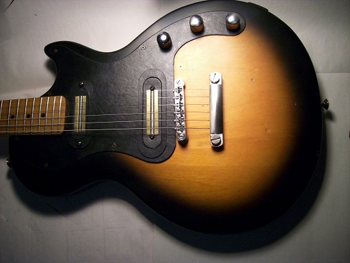

Testing to see if photo will upload. Success, this is the guitar I am proposing adding a zero fret to. That was the original mods, it has since been further modded. I will try to upload photos of current additions. OK the top photo has the current modifications as of now. The pickups are the 1959 Melody Maker pickups I wound.

Bryan is right about the new guitars, and the nut setups they come with. However I wanted to add that many times the new guitars have nuts made out of plastic or some junk material, and to do the new setup right the nut really should be replaced if not made of something decent, bone is the best.
