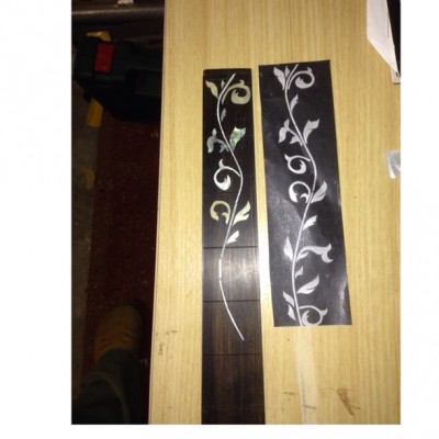

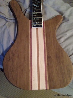

Nearly at the stage to start thinking about a finish for my first build.
I have walnut body wings with zebra wood and Purple Heart laminated pinstripes and a rock maple neck with sapele mahogany stripe down the centre.
I'm concerned about grain filling issues and what type of finish would enhance the grain but not muddy the different colours?

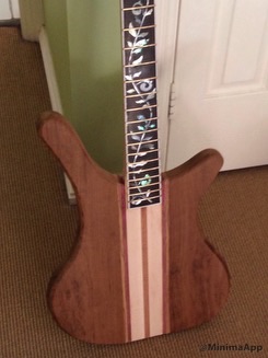

This might be a better picture

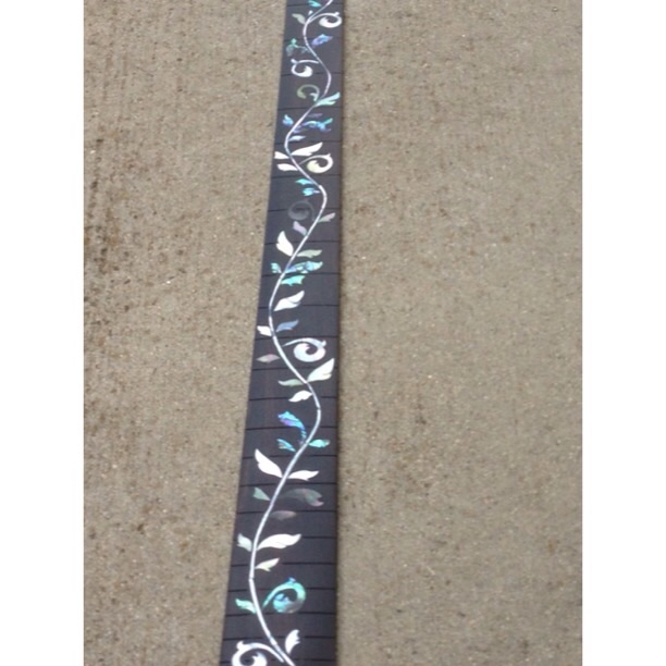

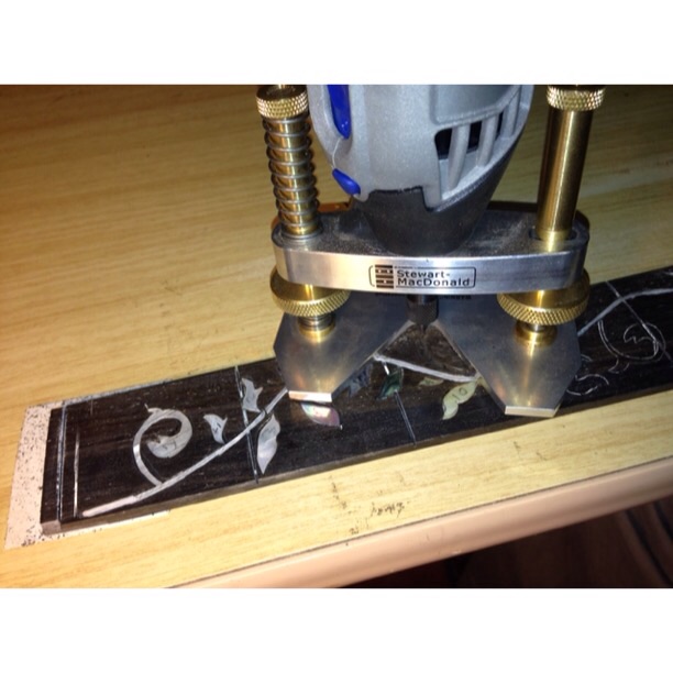

This will become a nice instrument. Did you do the inlay yourself?
You could consider a danish oil / thru oil finish.

Yes all the work done by me, although it's taken me 2 years to get this far!

Nice inlay - I'll never have the patience or skill to do something like that.
You can get a pretty good gloss with Tru oil - multiple thin coats, dry several hours between coats, sand if necessary, and buff/polish. You need to grain fill if the wood has open pores and you want a smooth finish. I suppose epoxy is OK, but I've never used it under Tru oil.

Finish sand through at least 220 grit to get all scratches out, wipe it clean, and seal it. It depends on what sort of finish you are going to use, but shellac seems to go well with most finishes. The point is to seal the surface so it doesn't soak coloration from the filler, then apply the filler and when dry sand level. You might need another application of filler to get the pores level, but you will see for yourself as you go. Just keep it up until the pores are filled. You may need to put another coat of shellac if you sand through to bare wood, but get it covered and filled, then you can put your preferred finish over the shellac. Probably the most durable and requiring the least equipment is an oil varnish with high phenolic resin content, or a polyurethane, thinned and applied with a foam brush. You could use TruOil but that would take many many hours and still not be terribly durable.
The effort you expend keeping things clean and following manufacturer's directions should pay off in a professional appearance.

Sometimes purpleheart can "bleed" a little color into lighter woods if the first coat of finish is applied too heavily. Misting on the first coat (if sprayed) or wiping on a thin coat and then allowing it to dry before applying the next coat can help prevent this.

I prefer the following approach, which works well for instruments with various woods adjacent to each other:
1) Spray a seal coat of lacquer
2) Apply tinted paste wood pore filler and wipe clean
3) Spray 6 coats of lacquer
4) Sand to 70% level
5) Spray another 6 coats
6) Sand to 95% level
7) Spray 2 or 3 more coats
8) Cure one month
9) Sand and buff
8) Cure one month
9) Sand and buff
