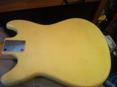

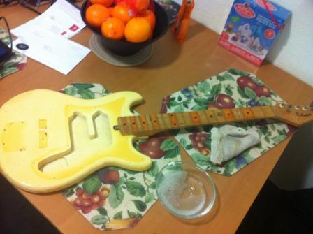

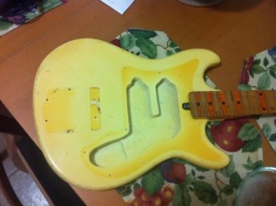

I just joined the MIMF community and had some questions about a repair/restore. This is my first time really fixing up a guitar before and want to make sure I'm doing the guitar justice. I recently picked up a Harmony H-801 that has been abused and I want to semi restore it. That may sound weird but it has a lot of character to it and I want to keep some of it. The body is a cream yellow but from age and neglect really needs a good finish on it. I was thinking of using on oil to seal it but I don't know how that will effect the paint. Also the neck is still intact but has a fair bit of road rash and the fret board has dried out. I'm not sure if I should sand it or just reseal it and if resealing how would i do that?? Ill post pictures and thank you for you help!!

Putting anything on that body will only cover the dirt and grimy oxidized surface. If you want to make it look good again then I'd give it a wetsanding with 600 grit and then 1000 grit and then buff it out. Any bigger or deeper dings and digs I'd probably just leave them because it looks nice to have the wear visible. In fact many wouldn't mind just keeping it as it is, or just cleaning it very well and waxing it. But oil won't help you.

I restored an old harmony like this a few years ago. It had obviously hardly been played, but was still rather dull brownish amber, and grimy. Turned out it must have had a coating of wax applied to it (maybe even from the factory- wax and buff is a lot easier than doing a proper finish). I removed the old, brown wax with isopropyl alcohol and paper towels, plenty of both. I discovered that all that wax had kept the finish underneath in really good shape, and that my guitar was actually bright orange! Buffed it out very lightly (the slight amount of residual wax was enough to make it glossy) and the finish looked better than new.
But check on a small area first! You want to make sure that the alcohol doesn't dissolve the colour itself. And regarding the fretboard, you should do a little reading on how to do a refret. This is the right guitar to learn how to do that on. It's often easiest to restore a fretboard with the frets off anyway.

I would wipe it over with white spirits (naptha, I believe in the States) to remove the grime and residue and then lightly polish it with some fine cutting compound to bring back the shine. Then as Mark says, give it a coat of wax - car wax is fine.
As for the fretboard - if the frets are in reasonable shape and it's just the board that needs attention, use a single edged razor blade to scrape between the fets until you achieve a smooth finish and then give it coat or two of lemon oil.
