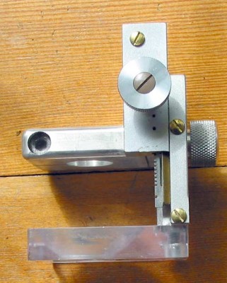

Re: Fretboard Inlays
Let's just say that the Dremel is pretty weak for anything besides automotive work like cutting off rusted mufflers. If I ever find one that runs true I'll be thrilled.
I tried the larger Proxxon but it's too slow so I ended up with an air pencil grinder that spins at 60,000 rpm. I bought and returned 3 of them to HF until I found one that's good.

Did you make an adjustable jig or base to hold it vertically, or does it fit into one of the commercial bases?David King wrote:I tried the larger Proxxon but it's too slow so I ended up with an air pencil grinder that spins at 60,000 rpm. I bought and returned 3 of them to HF until I found one that's good.

Peter, I made custom bases for all of them. For the Proxxon someone had given me a little focussing mechanism salvaged from something photographic. It looks a lot cooler than it works. A micrometer adjustment would have been more useful probably albeit slower to adjust.
